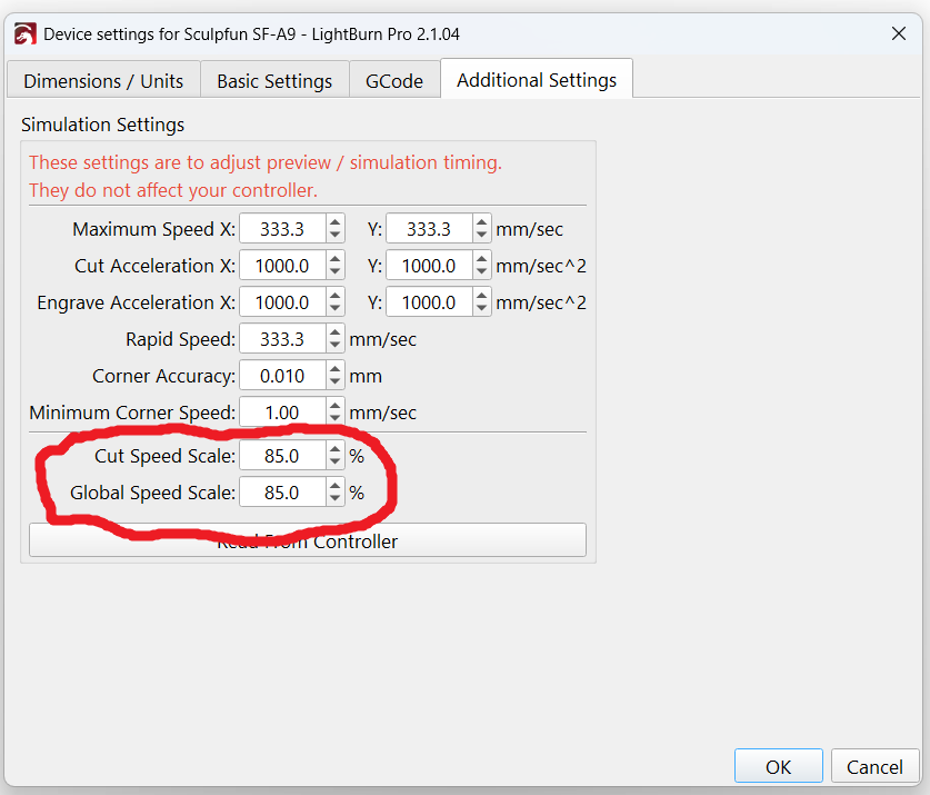

Now my Preview is within 5% to 10% for all work. How did I do that you say?
  1. Initialize values with the Read From Controller, which you did.
  2. Run a project that is vector-only that lasts maybe 30 minutes (record the time from the Preview window). No need to actually burn anything, just set the power to 0.1% (unlikely to light up the diode). When it finishes, touch nothing. Look at the bottom and you will see the actual run time. Write that next to your Vector Preview time.
  3. Next run a 1 hour project that is image-only (record Preview time on another line). No need to actually burn anything, just set the power to 0.1% (unlikely to light up the diode). When it finishes, touch nothing. Look at the bottom and you will see the actual run time. Write that next to your Image Preview time.
You now have two sets of numbers.
  1. Divide the Preview by the Actual for the Vector test. That is likely close to .98 or better.
  2. Divide the Image by the Actual for the Image test. You will see .6 to .7, but can be anything for your machine.
Now here is where the magic comes in. At least for mine, if you average those two answers, you will get close to the correction we are looking for. I did not know this last part until I had done a lot of trial and error with my settings. I had those image time errors mentioned above, yet look at the actual entries that got me real close.
What I write may work for you, or not. Feel free to try different from eachother percentages in the circled boxes below. You may have to experiment on your own.

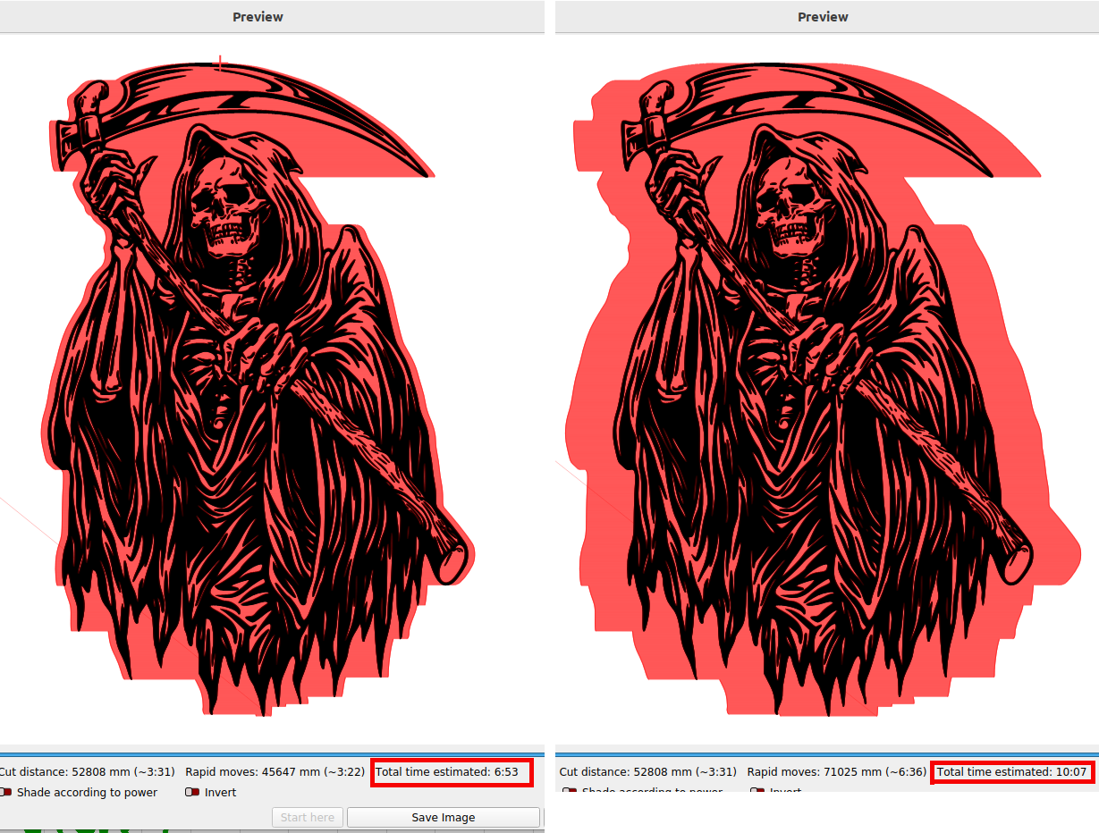

Often, overscans (acceleration and deceleration) from a certain speed become disproportionately long and make the overall processing time longer. But this should be easily visible in a preview.
Assuming it’s that machine, then the rated top speed is 20000 mm/min = 333 mm/s. Compare that with the controller’s actual maximum speeds in GRBL’s $110 and $111 parameters to see how the claim matches reality.
Although you can set the LightBurn layer speed to any value you want, the controller limits the machine’s actual speed to prevent any axis from exceeding its limit. That comes into play when the layer’s Scan Angle is anything other than 0°, but for ordinary left-to-right scans the X axis limit is as fast as it’ll go.
If the engraving isn’t one large block spanning most of the platform, then the time spent in the overscan areas while accelerating to the maximum speed and decelerating to a stop will account for most of the job time. Comparing the Rapid Moves time in the Preview window with the Cut Distance time will give you an idea of how the scanning speed affects the job time.
If you’re numerically inclined, you can feed the GRBL $120 acceleration limit into the RepRap speed calculator to determine the distance required to reach any given speed. Note that you must convert the speed from mm/min to mm/s. The result of that calculatIon may suggest using a much higher Overscan distance than the default 2.5%.

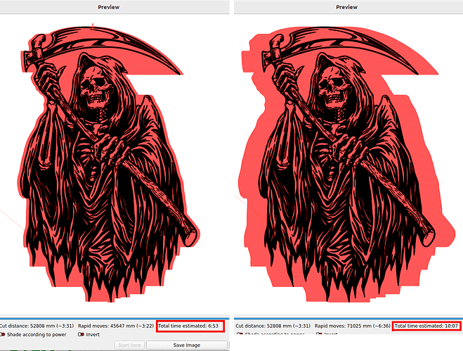

You can use the preview in Lightburn to show you the computed paths and times. Lightburn emulates the machine to build the preview, with show transversal moves is enabled the path of the head is output on the screen as red.
You can see, visually the red outline on the right is a 6,000mm/s^2 value for acceleration and on the left is overscan for 40,000mm/s^2. Note the time difference.
This is pretty obvious when watching it operate. If it’s over-scanning the same size area as it’s work exists, it likely isn’t saving you anything by running faster. Usually you can see it in the preview.

If you look at the documents, they do not really explain what these two setting functionally change how the machine emulates your machine.
Maybe @Aaron.F can shed some light on it for us. :folded_hands:
:grinning_cat:
“Cut Speed ​​Scale” and “Global speed scale” are used to compensate for preview time estimates. The last part of the video on the linked docs page briefly covers this.

“Global scale” basically adjusts everything at the same time. The Cut speeds are for vector cutting and offset fill, the Engrave values are for images and fills. On GCode based machines they’re almost always the same. On DSPs they may differ.
The global speed scales are still subject to acceleration limits though, so if the job is accel limited, boosting those numbers might not change anything.
Another question:
If I set my global to accurate for images, and it is too much correction for vectors, does the Cuts % modify the original total or the 85% in the Global setting?
