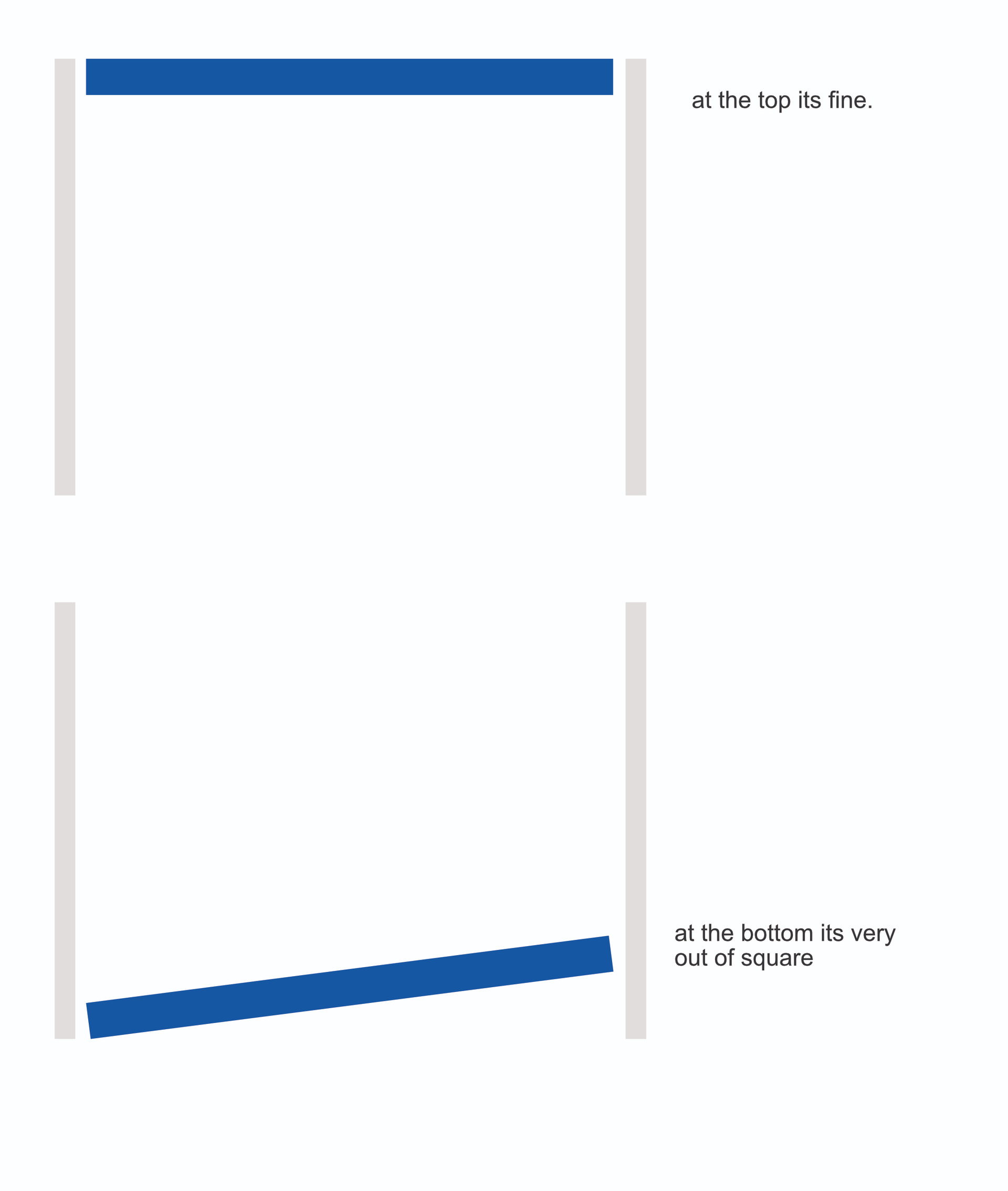

I have no idea what’s happened here - turned on the laser this morning and its all out of wack. the Gantry is true at the top of the laser bed, but wildly out at the bottom.
Any help would be appreciated!

Sounds like belts are loose or pulleys are slipping. Check everything out
yep, youre 100% correct - Ive updated the 1st post to say its been solved
yep, youre 100% correct - Solved!
turns out there was quite a bit of crud around the top left gear that was causing the belt to skip. Ive cleaned it and its now running correctly!
