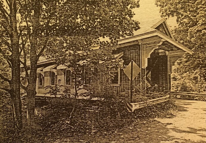

Please do not think this is an easy venture to accomplish the 3D illusion effect. You will likely need to do some extra “fiddling” to get your final engrave. Load the finished PDF into LightBurn and complete any and all final adjustments to your image.
I sincerely hope folks appreciate this. I have spent many hours and lots of material to do this. REMEMBER: Your laser and other things may require work on your part to get what you want.
Do not select a photograph or image that is very finely drawn etc. They do not work real well.

You are right, there is nothing in a photograph with 3D info. With this method you add the depth map to gain the illusion.
Some portraiture is very difficult. Mostly because of the many fine aspects in a photo these days. As I stated before, that doesn’t render well. Drawings are the best and easiest to do.
This is from a photograph. I used Stucki for this one.

This was taken from a photo.
Image after conversion.

I think you guys are talking apples and oranges.
@ferg is using a Photoshop effect with something they refer to as a depth map. This is basically a way of faking depth of focus and allows you to maintain focus on the areas that you want and provide somewhat realistic “out of focus” blur to elements not on the focal plane.
Think of this like “portrait mode” on modern smart phones.
This is not a variable burn depth technique. It’s more a focal illusion technique.
