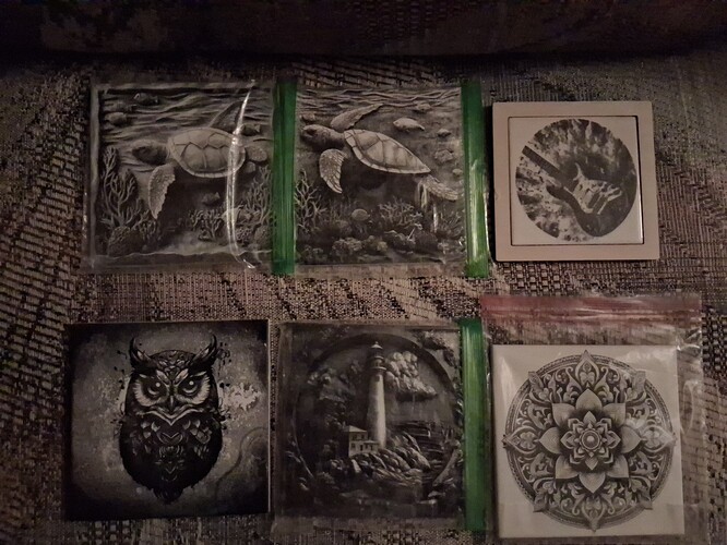

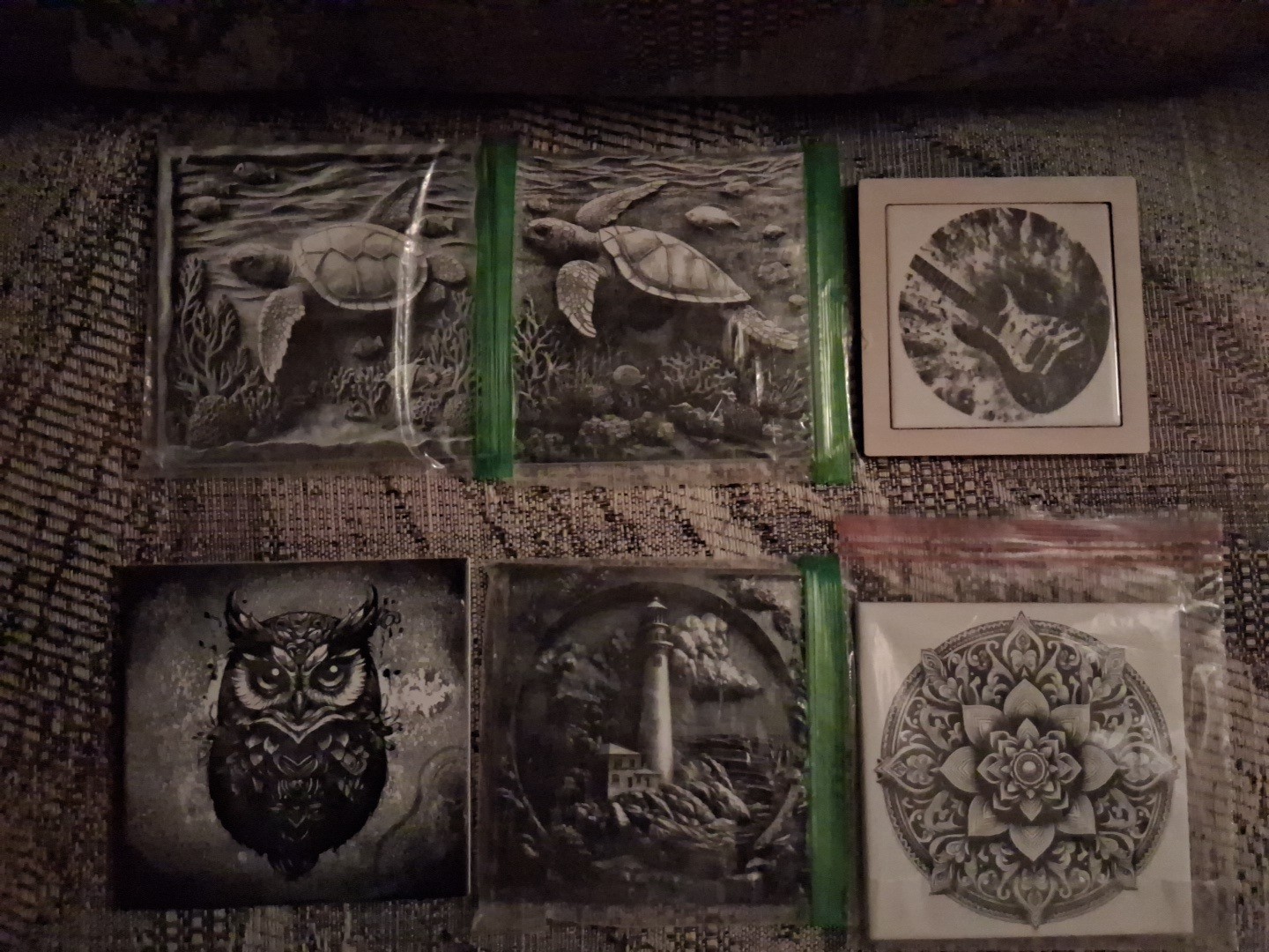

Here are some examples of ti,es I’ve done using 1 part Titanium Dioxide to about 2 parts 91+% alcohol. Glowforge settings are 1000 speed, 100 power, variable power, and 225 LPI. Sorry some are in baggies for protection and the lighting wasn’t great.
