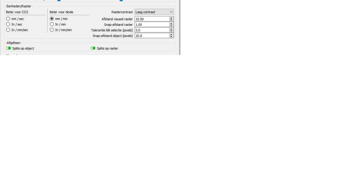

To big lightburn 0.9.14
I have version 0.9.14
is better for diode mm / min
but if I draw a square of 10mm it becomes 30mm
drawings also become too large
where can I change that ??
And text is linked together
how do i get that right ??
solved
The letters that were connected with a line
32 = 0 changed to 32 = 1
and steps got up
100 = 250 changed to 100 = 90
101 = 250 changed to 101 = 90
102 = 250 changed to 102 = 90
Double check your numbers - 80 steps per mm is very common. If you run a square of 100mm and measure, you can adjust further if you need to.
