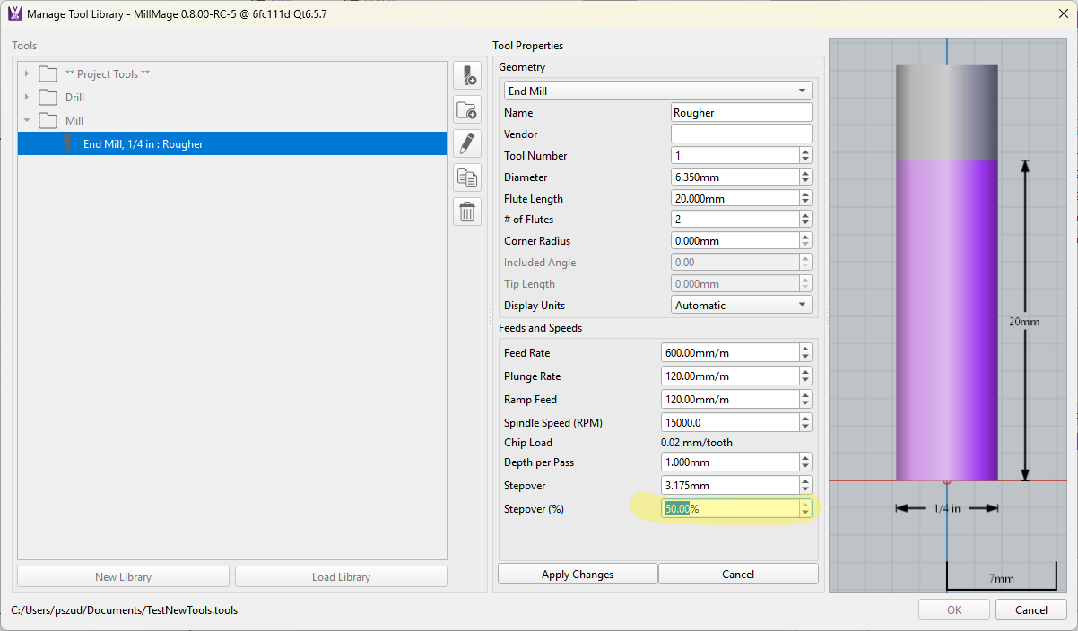

Tool editor limits Step over to 50% on RC5
As I talked about, I have a series of tools from IDC that are quite aggressive, and can do more than 50% step-over.
" Featuring a staggering 3/4" depth of cut per pass, an 100ipm plunge rate, 80% step-over, (it is actually capable of feed rates as high as 800 inches per minute on floor-model machines) the “BEAST” is the undisputed champ when it comes to rapid material removal from your CNC router woodworking projects."
The current tool editor caps out at 50%. I think this limit should be removed, or capped at a higher rate to allow these more aggressive tools. ( But still not to exceed 100% of course. )

Besides foam, Basswood and soft pines can be full bore 100% with some roughing bits, heck, even with some finishing ones. I am sure I can think of a few other cases for 100% engagement. So I also don’t think this is a feature .. it is a slight bug. As one of my old bosses 50 years ago… you aren’t supposed to protect the user from doing something stupid… :slight_smile: Warn him if you need to, but not prevent him. Generally a machinist knows the feeds and speeds as well as stepovers for his material.

The 50% step over limitation is a temporary one. It was causing some edge case issues in path generation, so it was limited to 50% to avoid them, for now, while we work on that solution.

Yes, that is confirmed. There is more work to be done with Medial Axis before 100% stepover can be unleashed. The math involved with calculating the center of a given shape or path is actially very complex. I was told by dev that it is coming, just not with the initial release. So full width pocket clearing and rapid milling will come soon !!
