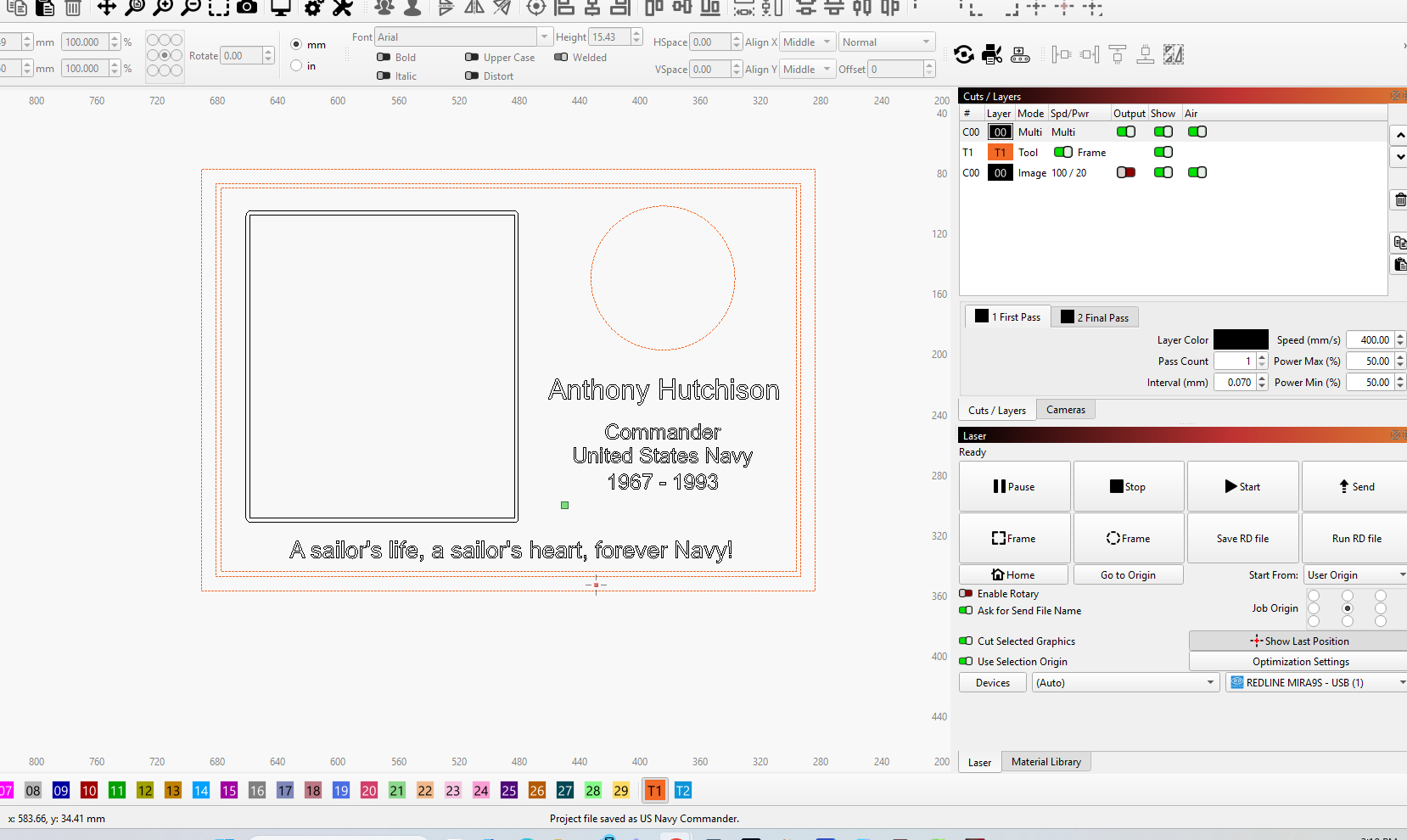

Am I missing functionality or not using lightburn correctly for this - I want to use a Tool layer to keep objects aligned during layout, and leave the Tool Layer in place so all objects laser at the correct location using User Origin. BUT with this workflow I cannot frame individual objects, lightburn only frames the Tool Layer. Is this User Error? What am I missing?

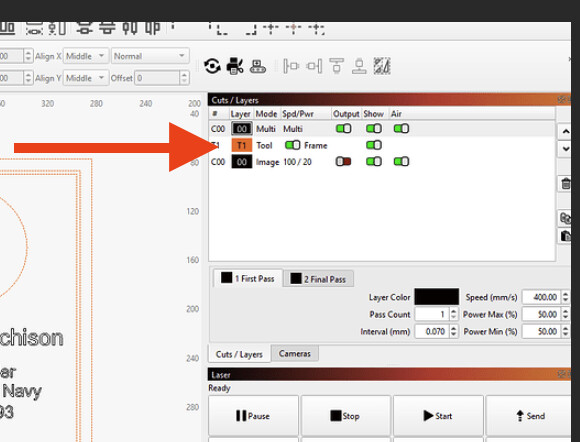

Do not select the tool layer -or- under the cuts window turn off FRAME for the tool layer
For this file I am using a gantry. File size is too large to send. I will try to share a link.
Did you program the start from position you are using, ‘user origin’?
If you don’t want to include the tool layer while framing, disable it from framing in the cuts/layers window:
