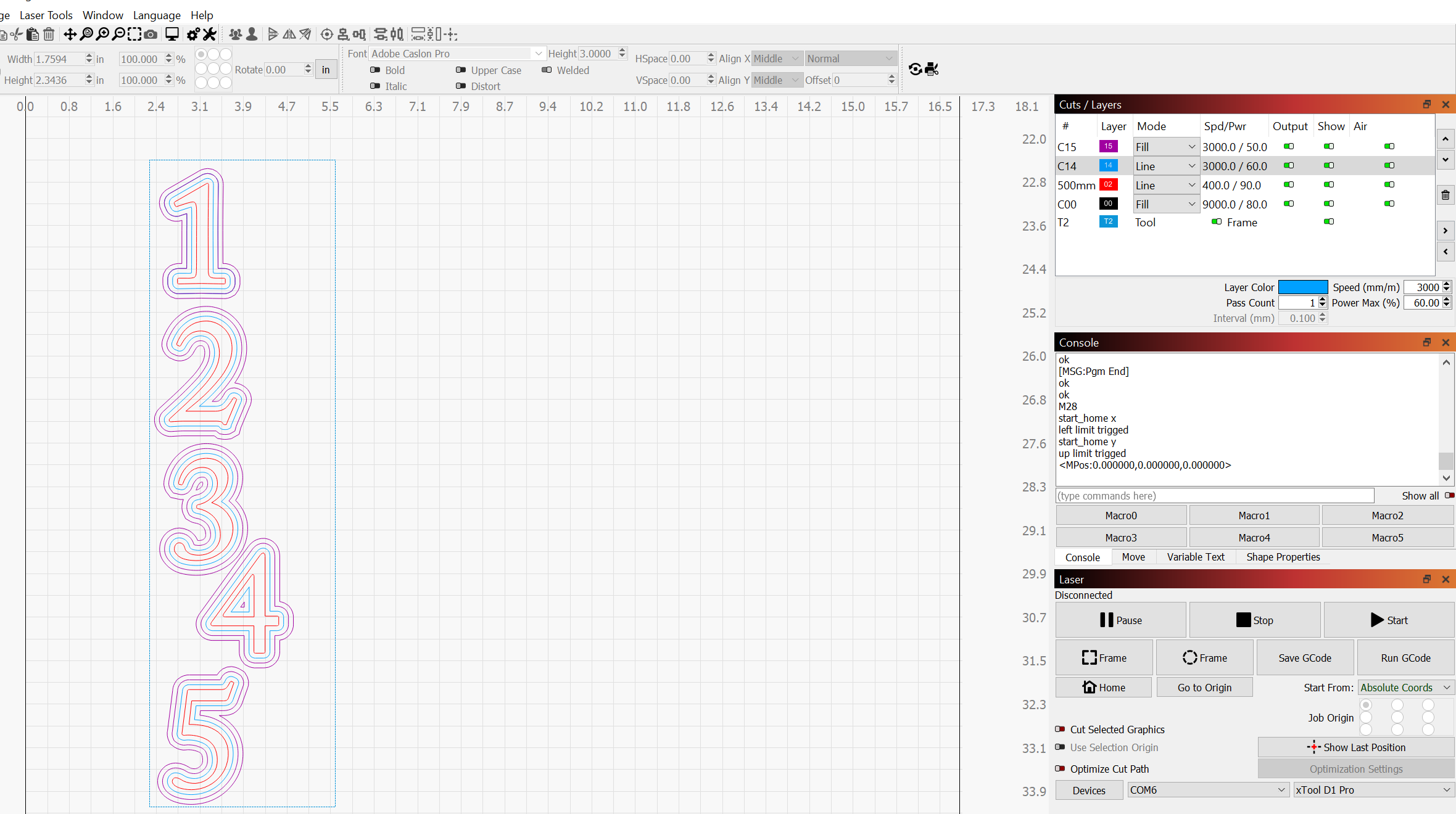

I am hoping someone is able to help. My tool layer is not framing when I frame. My layers also are not cutting or scoring lines in the order I have them set. If I have line or fill set first and cut second it always cuts first. I do have the latest version for LIghtburn as well.
Can you post a photo of your cut/layers pallet?
I can confirm that, T1, T2 are not framed even though they are set to do so.
(Mac OS Big Sur, LightBurn 1.4.00-beta)

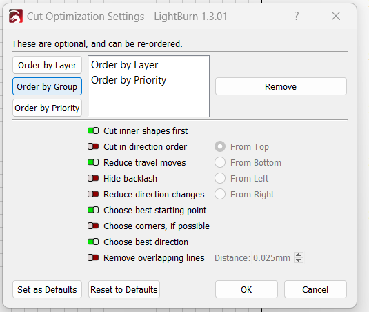

I don’t have an answer for the tool path, but I see you have “optimize cut path” off. If you turn that on and open the “optimization settings” there are options for “Order by”. Order by Layer should help.
Thank you! I will give that a try.
For T1&T2 use rubber band framing.
