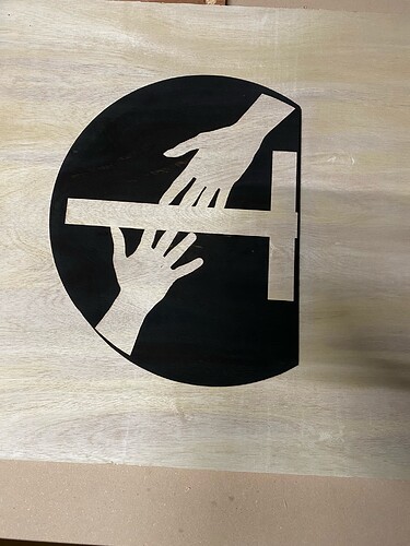

I have a large logo project that had to be burned very dark, so the project ended up running for 36 hours and quitting for an unknown reason. The point is I need to complete a logo, on a burn that takes a long time so I cannot simply rerun the file. I thought the perfect solution would be to add and image mask simply blocking the portion of the logo that is already etched and save new GCode file. However I cannot get the image (PNG) to go to a tool layer so I can add the image mask. Looks like I can only add a vector to a tool layer, but cannot add image mask to a vector. I would love any help getting this done I do not want to dump 36 hours of work. Thanks

Can I ask what material you are burning to how you’re getting such a dark burn?
I think is the answer to how dark it is…
