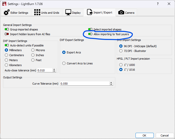

Trying to import SVG with tool layers from our production software and having NO luck.
Did some testing exporting directly from LB and reimporting the LB created file and tool layers still vanishing.
Am I missing something here?
EDIT - Inkscape shows the tool layers as having distinct RGB colors, so they’re not getting translated on the way out.
If you enable “Allow Importing to Tool Layers” it should work. I’ve just tested and it works for me.
THANK YOU.. for the life of me I didn’t remember I had to set that explicitly.
