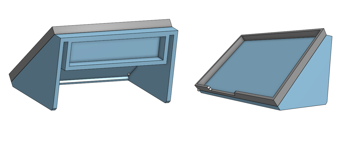

At first I thought I would just place it on top of the Laser, just above the Ruida Panel, but I had plans to install an Analog Milliamp Meter there (since done), and more importantly, I feared that I might be reaching for the Touch Pad and inadvertently bump down on the Emergency Stop Button and really mess things up. So I jumped into OnShape, my now favorite, free, browser based, Parametric Solid Modeler… and designed a Magnetic Mount for the Touch Pad.
I designed it around a pair of Harbor Freight Magnets, which I keep a stack of, on my metal workbench… they are great for holding things in place on the metal honeycomb bed.
Here’s a couple images of the design file from OnShape:

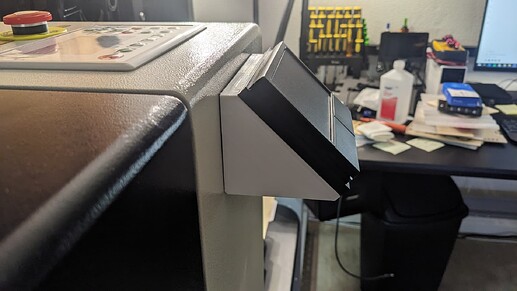

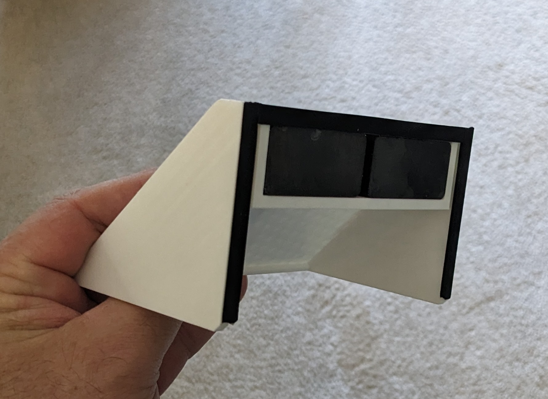

I printed the parts on my Son’s Ender 3 V2 3D Printer… first the mount (seen here with the magnets glued in, and some rubber stripping to keep the device from sliding down the smooth metal chassis of the Laser):

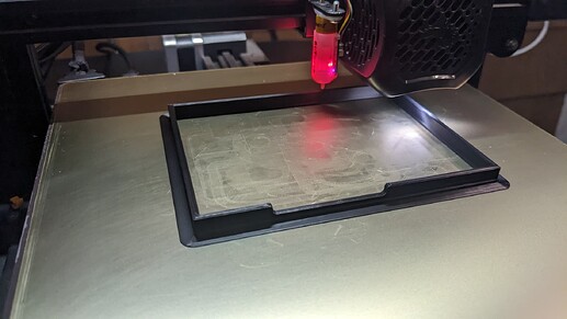

I had originally thought about attaching the Pad to the new Mount with double sided tape, but I knew I would need access to the bottom of it, if I needed to swap batteries. And I thought about Velcro, but didn’t want it to feel sloppy, so I just added a trim piece around it so it sets right in. Here is the Trim Piece being printed. (Note the cutout for the On/Off switch):

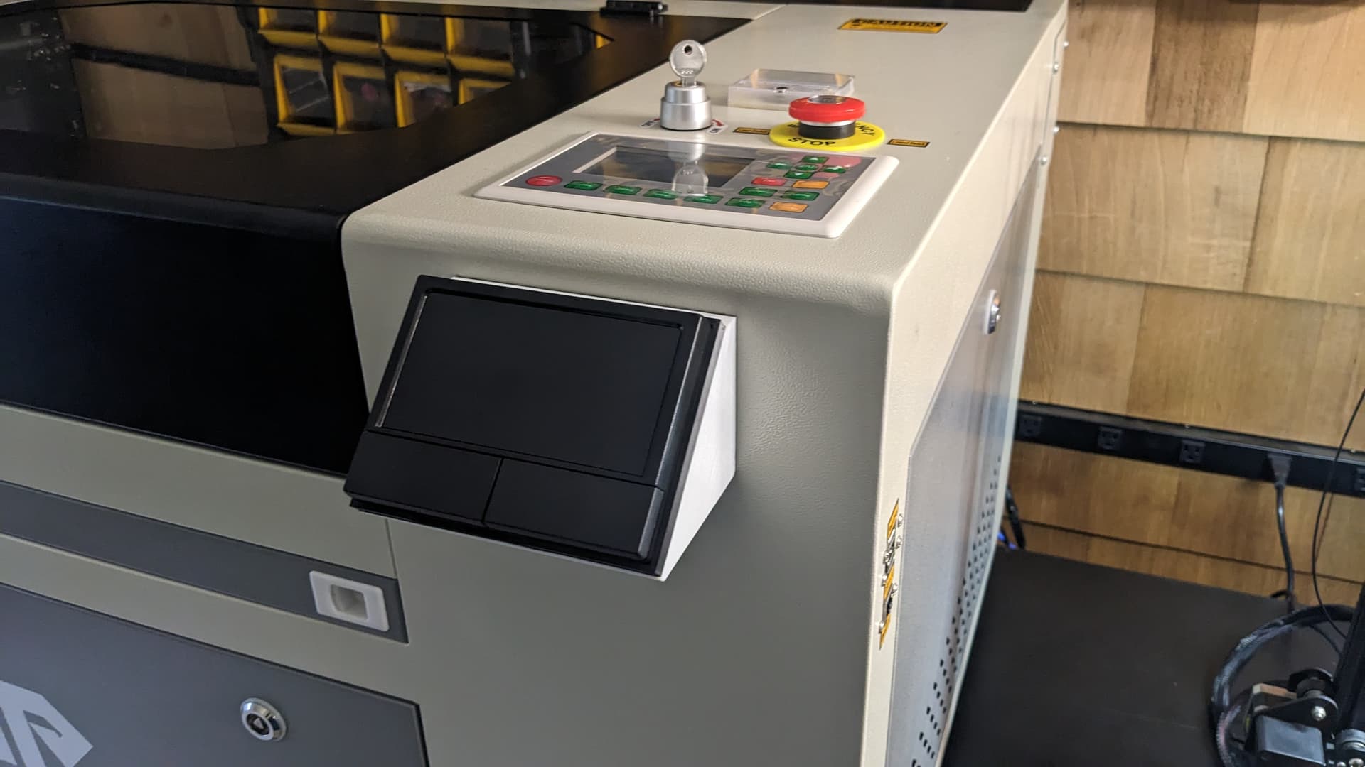

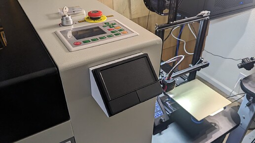

The final product is just great. Now I can control the Lightburn Computer from the Laser, and my mouse is back over at the Computer where it belongs:
And because the Touch Pad is just nestled into the trim piece, I can easily move it anywhere else I might need it.
