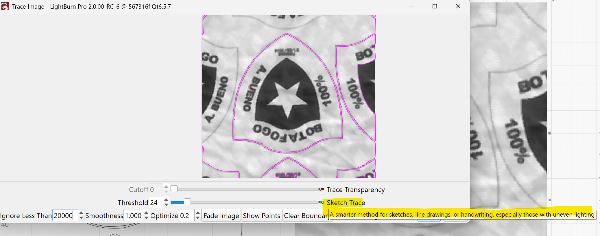

Ola pessoal, gostaria de saber como o contorno de minha imagem após fazer o traçado com a camera, não quero que ele corte oque possui dentro do meu desenho! Gostaria que fizesse o traçado apenas onde esta a cor vermelha… Olhe esta imagem para que entenda melhor https://i.imgur.com/uRmA6qO.png
Hello everyone, I would like to know how the outline of my image looks after tracing it with the camera. I don’t want it to cut what is inside my drawing! I would like it to only trace where the red color is… Look at this image to understand better https://i.imgur.com/uRmA6qO.png

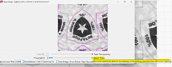

You’ll need to play with the sliders of the Trace function to catch the red outline.
I took a screenshot of your image and these settings worked for me:
  • I used the “Ignore Less than” value to exclude everything except for the largest shape, the outline. But you can also trace everything and delete the unused parts.
This gets you this shape:
Ungroup it and delete everything except the outline and Optimize Selected Shapes to smooth out some rough edges, if you want:
Use Offset Shapes to make the shape slightly larger than your design, to achieve this:
Do you plan to cut each of these badges? - It might be difficult to get the alignment perfect..
