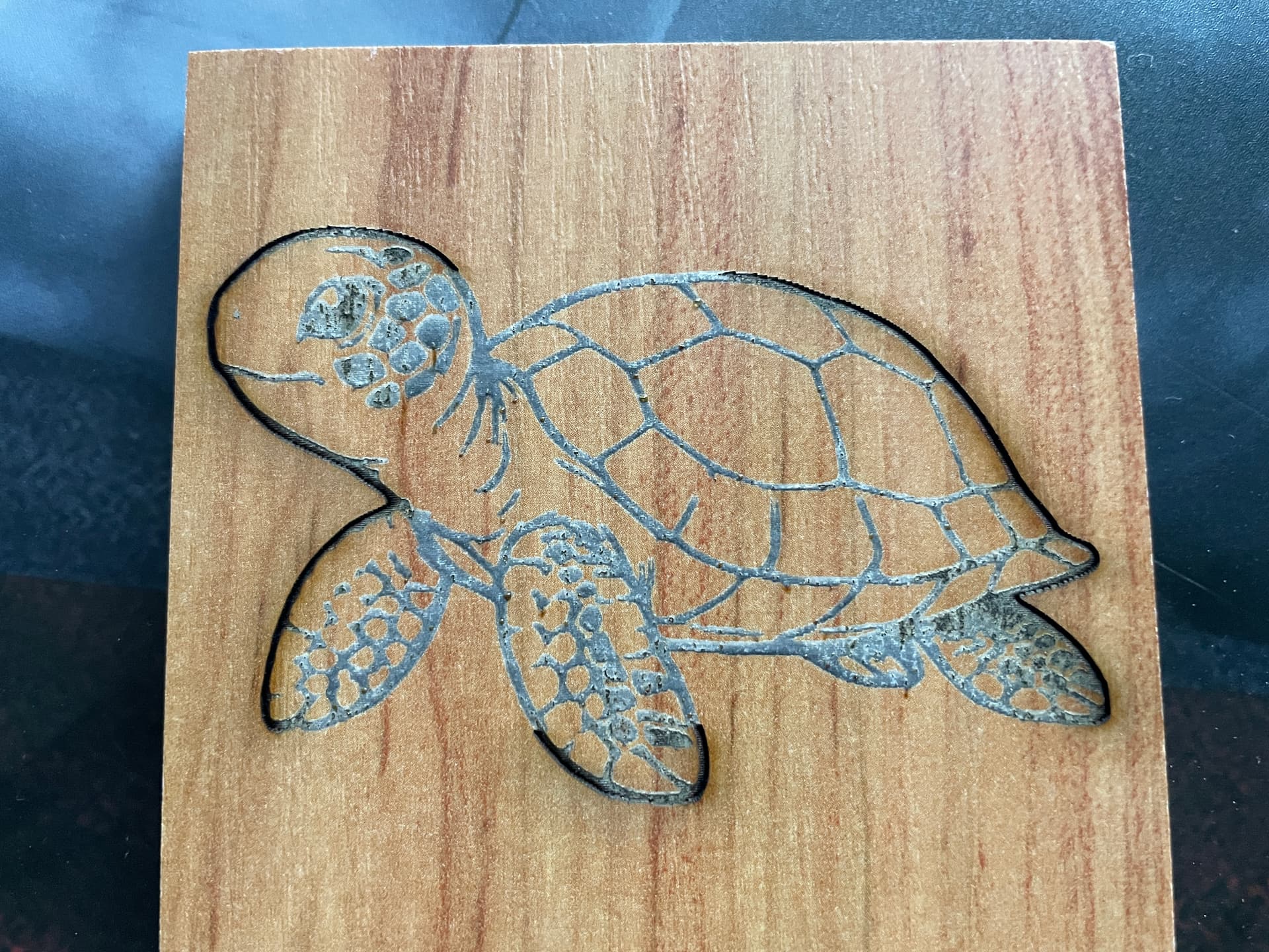

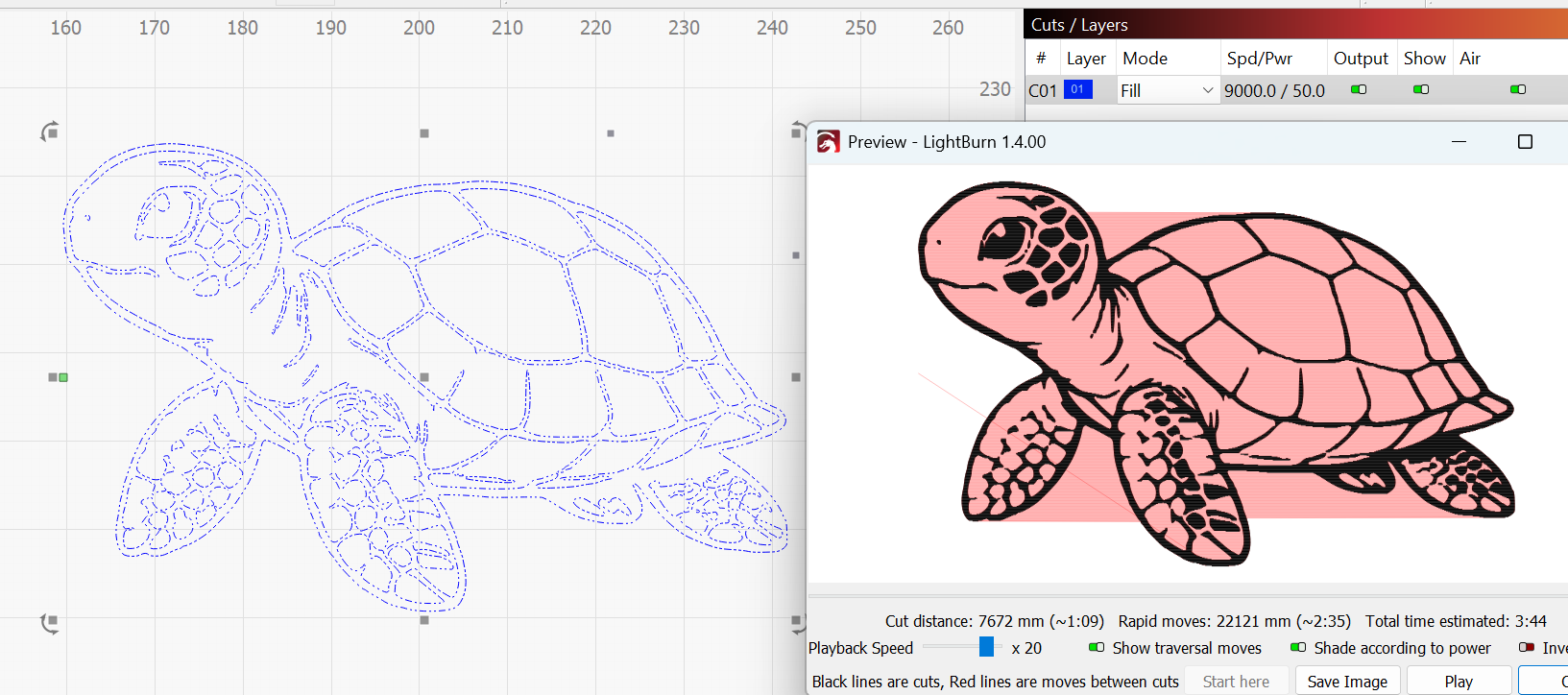

Tracing an image and deleting the original, all lines are well defined and in preview looks to perform perfect engraving…yet when engraving using the fill option, one a single layer, some lines come out dark, and some light. Using the original image all engrave 100% correct.
Problem seem to be with traced image not having constant power. Have tried previous versions of the software up to 1.4, no difference, all lines are dark and light in exactly the same places every time. Also tried different images, same result when traced.

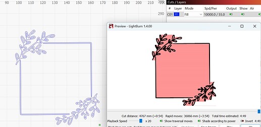

Seems like you should be using Line instead of Fill on these images. Because there are duplicate lines in both images. Also try changing Cut/Layer to Constant Power

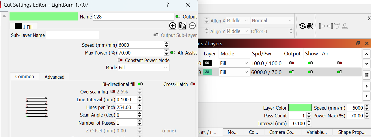

I have resolved the problem, but not sure why the problem exist. Layer C01 is not working, and same settings on Layer C28 is giving the desired engraving with constant power. I have attached files for reference.

The differences are you have min power @10% on C01 and 20% on C28. 10% is probably too low to fire your laser, certainly not consistantly. I suggest setting min and max the same on a normal fill layer. I only use min power in line mode.
Yea! Wohoo!
Now I’m confused :blush:, as my Cuts/Layers screen, or Cut Settinsg Editor does not display Min Power %, only Max :question:
Oops, I opened your files with my C02 profile active and those are the results I got. When opened with a GRBL profile, there is no min power setting. Sorry for the confusion.
