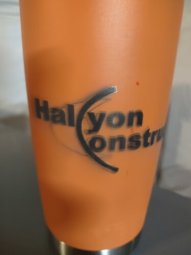

My wife and I were messing with the file tonight and thought we got it figured out, but after engraving on a tumbler, this is what we got. The outline of letters around the half moon shape are off. This cut time was about 6:30 each cup. The file that you all helped me out with was around 22 minutes. We now think we’re going to have to draw the have moon shape and place it in the image. We’re just at a lasd right now.
I didn’t think it was a galvo…?

I thought you might like this… the grey in the background was done in halftone.
One trick I’ve used is to add the entire image as a layer and burn it at low power to “dent” the coating. Then add a copy image as a second layer minus the 1/2 moon at normal power. Lining up is impotant of course. This means editing a second logo to remove the 1/2 moon. I did an owl this way on a Yeti with 6 layers. Took forever and looks great. Would I do it again?
If I remember correctly, I put the moon, bar through it and the lettering on different layers… All that would need to be done is set the moons output to off…
Since it’s a vector you can fill any layer with anything you want…
