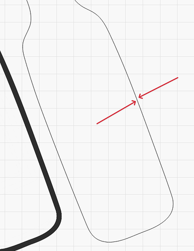

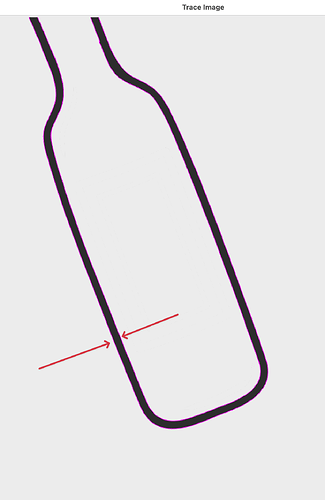

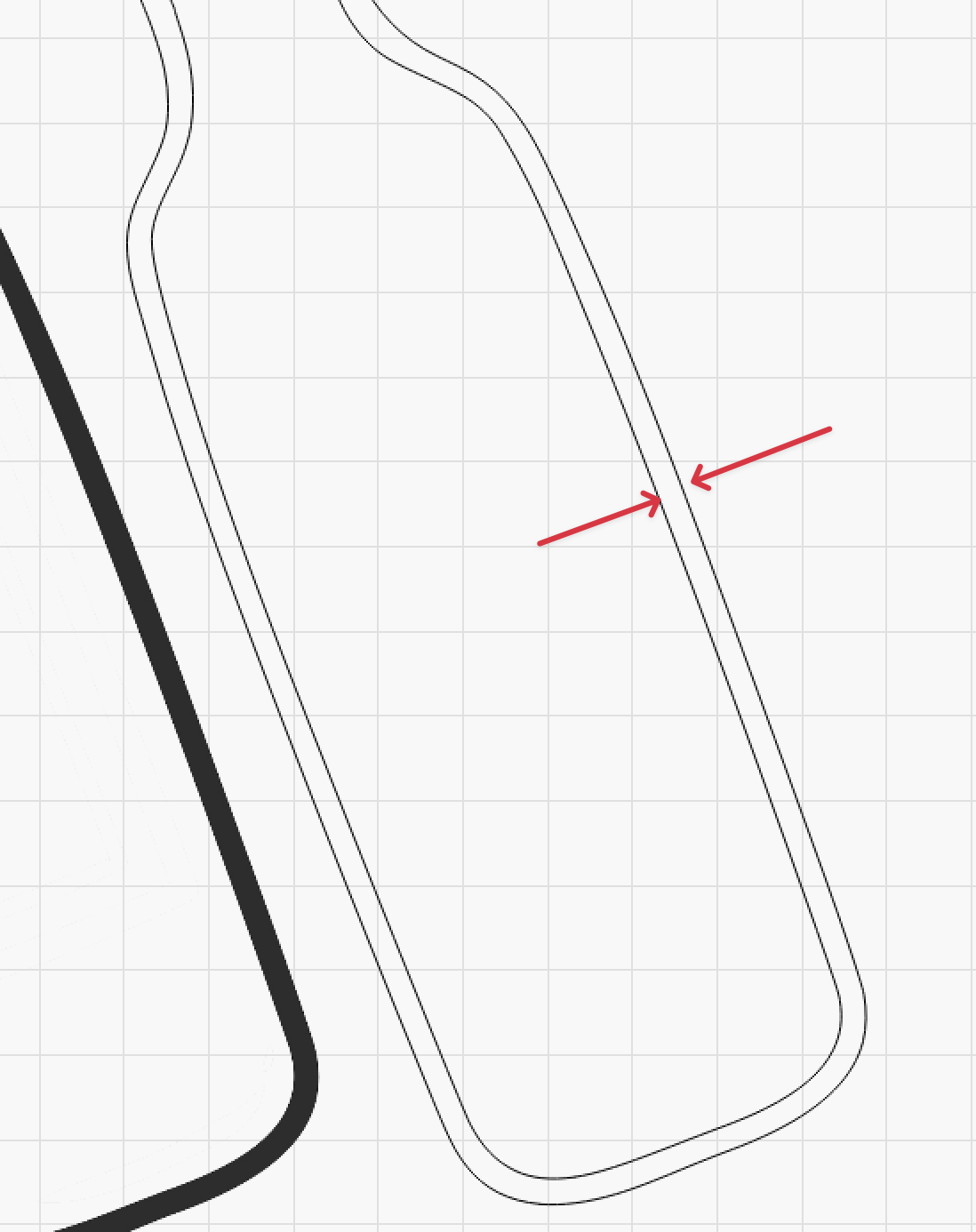

Is there anyway to have the trace tool not produce double lines when tracing a piece of art? Is there a way to have it just produce a single line other than having to go in and delete every single line that is adjacent to a double line. What I’m asking is can the trace tool be set up to trace down the center of what would be a trace line instead of making the trace on either side of the line?
No, not in LightBurn. Other applications including Inkscape do offer centerline tracing.
No, unfortunately, but if they are very simple objects, like a wine bottle for example, you can try to see if it is possible to close the shape and set it to fill and trace it again, then you will get a single line from the outer edge .
