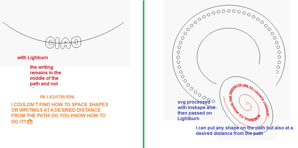

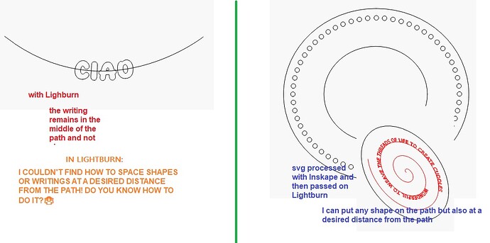

Thank you so much for your advice…but when I create the same thing on Lightburn the writing remains in the middle of the path and not above, I can’t move it at a controlled distance, unless I consider it as mirrored with the path. With Inskape I can put any shape on the path but also at a desired distance from the path, like when I have to put shapes suitable for sewing holes etc. I don’t know how to do the same thing with Lighturn…where I then transport all the created svgs and further elaborate them in polyline. Can the same be done with Lightburn only? I haven’t been able to.

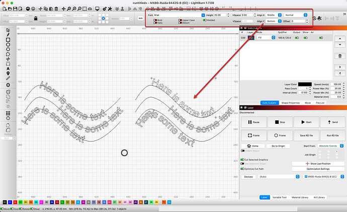

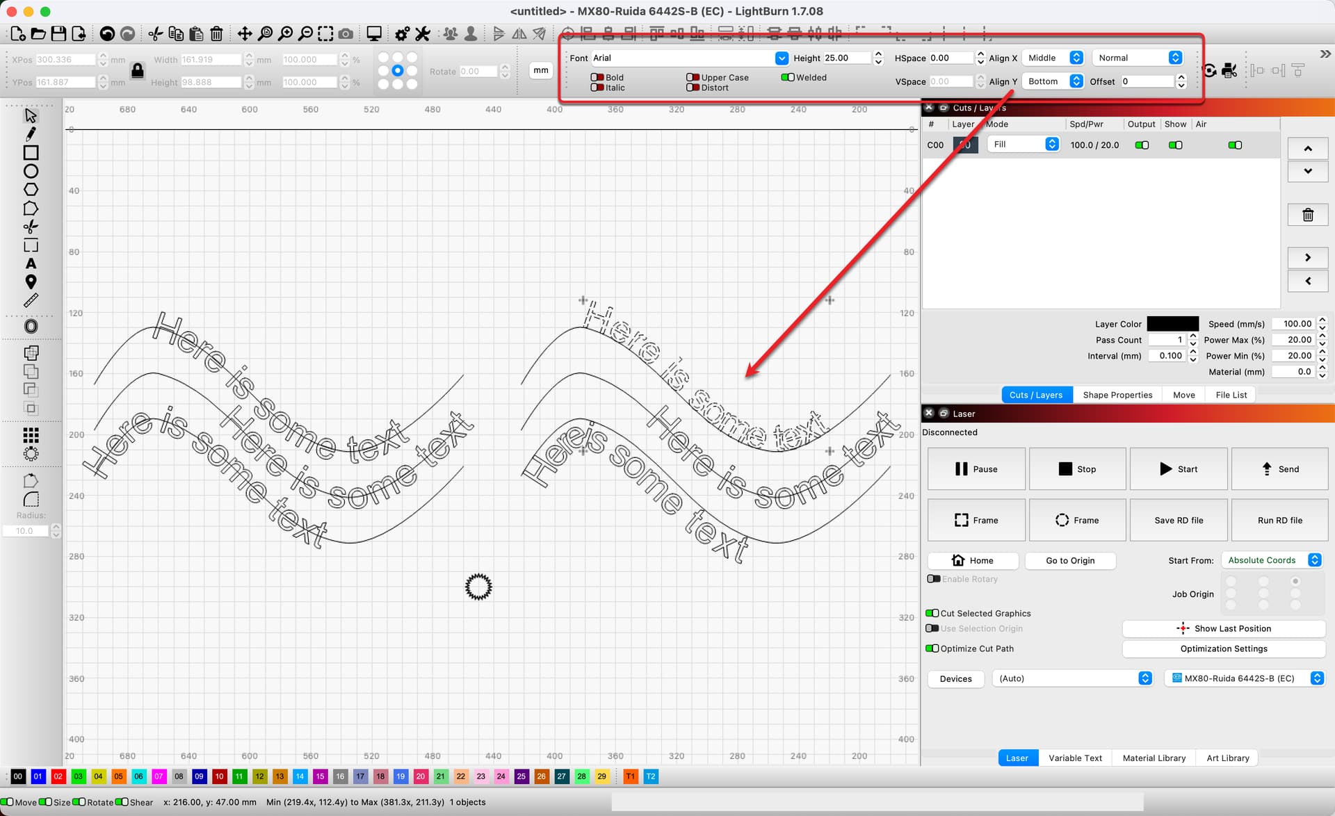

I am not fully aware of nor familiar with all the options available within Inkscape, but for LightBurn, you do have options for placement and alignment using the following controls.
