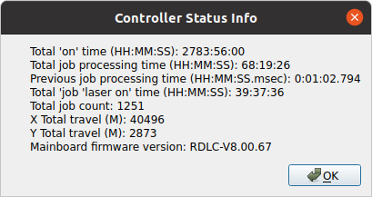

This is tracked within the Ruida. It know how long it’s been awake and how much the laser should have lased.
Edit → Get controller info
Forgot to add that these values cannot be reset or modified. I changed out my tube, but there appears to be no way to reset this data on the Ruida…
