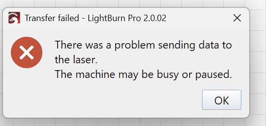

Transfer Failed, been working for years!

To make sure: Is this the error you are seeing?
Do you recall: Did this issue start appearing when you upgraded to version 1.7.06, or did you already have this version and it suddenly stopped working?
If it started after an update, please see if communication is restored when using LightBurn 1.6.03.

Yes, this is the error I am receiving.

Downgraded to 1.6.03 and transfer completed. Log attached.

Do you have the ability to connect via USB temporarily, just to see if that works?
I will try it. Though I never use USB.
I can send files on USB with 1.6.03
So can I get to a newer version?
What about V2 on a WIN10 machine?
I sent you a private message with a version to try. You should see a little “Envelope” icon in the upper right of the window - click that.

Thank you for chiming in. In the other case, a newer version of Lightburn sent the controller a command that’s not supported on older hardware. - The test version OZ sent to William worked, and the change will be included in an upcoming update.
