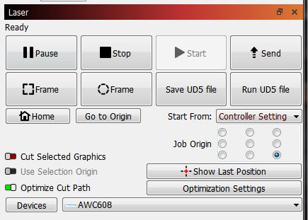

Hello,
Lightburn user since 2020
AWC608C controller, Win7 Dell Desktop
Connectivity via ethernet through 8 port switch.
Setup has been working for years without issue.
All cut files deleted from controller memory.
Laser CAD operates perfectly from the same computer and hardware. (Computer, cable and network)
Lighburn V1.7.06 has lost ability to transfer files. The “Transfer failed” pop up is always displayed.
The laser will respond to “Home” and “Go to Origin” from the Lightburn Laser menu. So there is some communication.
“AWC608” shows in the “Devices” list. IP address is correct. Stopped working after upgrade to V1.7.08 No other changes. Reverted back to V1.7.06 still not working.
Tried installing trial version of V2.0.02 on a different WIN10 machine connected via same network and cable. Same “Transfer failed” error.
Been trying to get back functionality for three days.
Any help would be appreciated. Thank you.

Since you’ve changed everything, it seems like you should double check the network.
On a Ruida, the address is static, you have to allocate that address in your router to be applied to the MAC address of the laser. If you don’t do that, then it’s easy for a different boot sequence in your system to attempt to give it another address. This ends up as duplicate IP on your network.
This can create these issues.
Again, my Ruida may handle IP address differently, but you’ve swapped out everything else.

I’m not sure what you mean by “Since you’ve changed everything”?
On the Trocen AWC608, the address is also static. Been the same for years.
You can see the “Home and Go to Origin” buttons in the screen shot. They work as expected.
I can ping the controller from this PC as well.

As a quick test, turn the laser off and try pinging it again. If anything replies, the router has assigned the laser’s IP address through DHCP to another device, in which case you must fix that.

There is no response to a ping test when the laser is powered off or disconnected from the lan.
The WIN7 computer with LaserCad and Lightburn installed, still works fine via LaserCad via ethernet. This has been my long term operating setup.
That’s good news of a sort: it’s not another device squatting on the Ruida’s IP address.

Since the laser responds to home and go to origin commands there is obviously some form of communication between the two. How full is the controller? What does the file list show in Lightburn? Sometimes the controller does annoying things when it’s memory is full or close to full.
Window Menu> File List. This should show all the files loaded on the controller. You can delete files from here. Worth a try.
I would agree that some communication is taking place. The controller is completely clear of Lightburn work files and LaserCad work files.
I can send files to it from LaserCad from the same PC.
Can you talk with it in the File List window? Just one more communication test.
Edit: Although if there are no files there at all the file list just shows blank. But if it’s not communicating, I believe the buttons are grayed out. Send a file from lasercad and see if Lightburn sees it.
