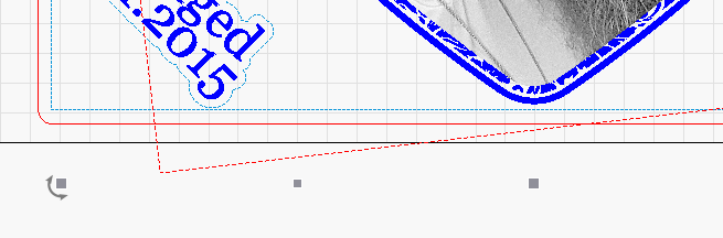

Transparency being considered burn lines and won't allow job to start for rotated image
I am trying to burn a plaque with a large image. I have used a shape to crop the image, then rotate it as I need. The rectangular extents of the image are outside of the work area. The truncated/cropped image is FAR from outside the image. I cannot for the life of me get the job to send, despite none of the area that is outside the bed containing any data at all. Please help, I cannot reduce the size of my job to make it fit.

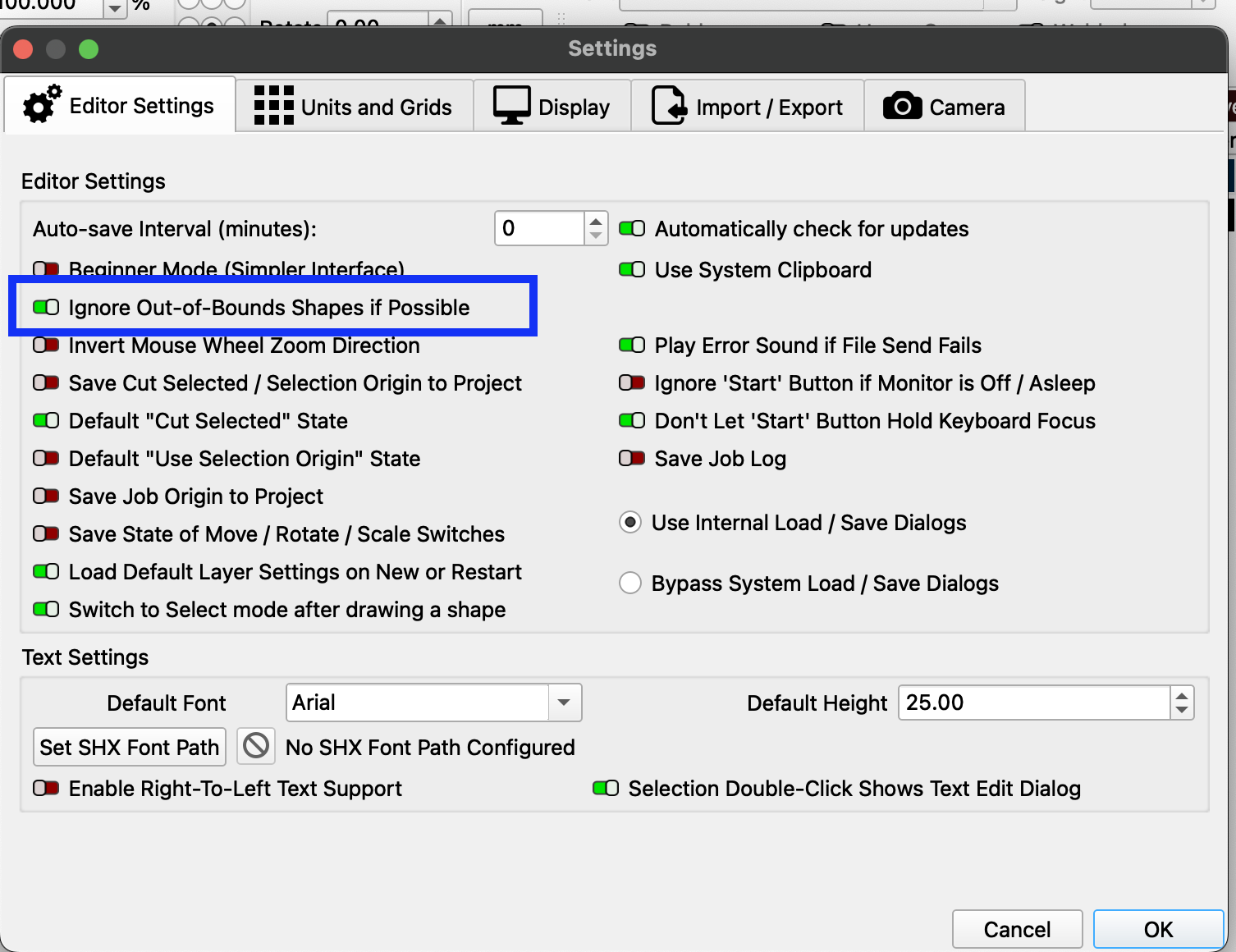

Possibly disable this switch? Might cause crashing into the rails, so beware.
Hit your preview button and turn on shown transfer moves. The red outline that shows where the laser head will move, if that crosses the boundary of your work space, you will have problems getting the file to run.
