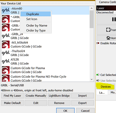

Click Devices duplicate your laser
then edit as a custom GCode device profile as GRBL-M3 flavor with the following options:
thank you, your post gave me an idea.
when setting up an atom stack for the first time you have to use GRBL-M3 (1.1e or earlier).*
then the rapid movements will work but then he has hardly any cutting performance.
I know it works but only use GRBL-M3 respecting the instructions or else other problems will arise.

A thousand apologies. I have a few device profiles and used the wrong.
The correct and checked options are as follows:
