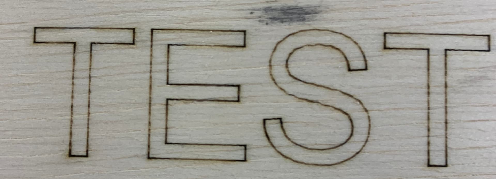

Problem Description
Traversal lines are appearing when running a job, as shown in the pictures. I have verified that $32=1, is enabled, per the common setup tips we’ve seen across several forums and blogs, and have confirmed this via the console output in Lightburn.
It seems the laser is not turning on and off when moving between letters.
I am at a loss of what it could be, and hoping someone can help this NOOB out.

With a spindle cnc machine, you don’t turn off the spindle, you lift it, then move it. With a laser, you can’t do that, so the $32 variable sets the machine to laser mode, that turns the laser off when it moves.
You have it set correctly, but it’s clearly not doing what you expect.
What I’m looking at, I’d expect more transverse lines if it wasn’t in laser mode.
It would be nice to see how the machine operated. Did it go places that it didn’t leave a mark?
You also have some mechanical issues as you can see the line wiggles on your output.
Jack

Can you make out where I see the wiggle? From my time with these, I think it’s a Y problem because it appears when the X axes is drawing something and it goes in the Y direction…
Make sense?

SOLUTION has been discovered…
I landed up looking at the PWM signals and turns out I had a loose/disconnected wire on the +5 side of the PWM signal.
Fixed the wire, and re-ran the test… Worked as expected.
We also discovered, mechanically, 1 of the bearings was loose and that fixed my wiggles issue as well.
Here is a good test run
Jack, thank you for your help today! It’s nice to know we have a good set of folks helping NOOBs like me… much appreciated!
