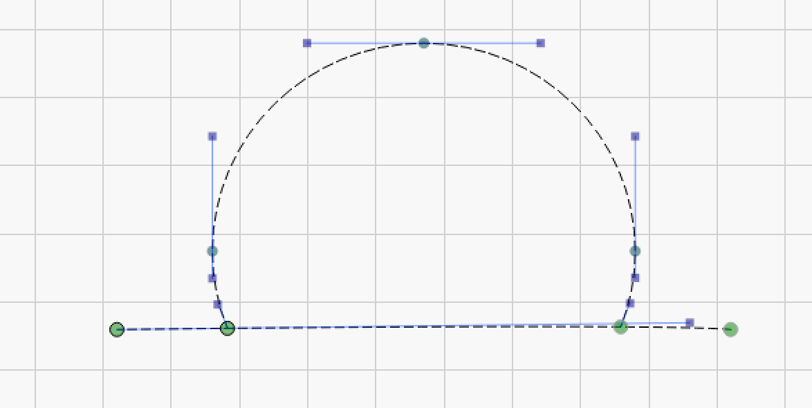

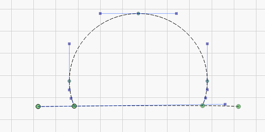

If you drew the circle using the ‘Create Ellipse’ tool, that will produce what is known as a LightBurn Primitive Shape, which has certain specific attributes known to LightBurn. To node edit a Primitive shape, you must first use ‘Convert to Path’ from the ‘Edit’ menu or right-click and choose from there. ![]()
Once converted to paths, here is what my test shows using the ‘Trim’ feature as discribed.

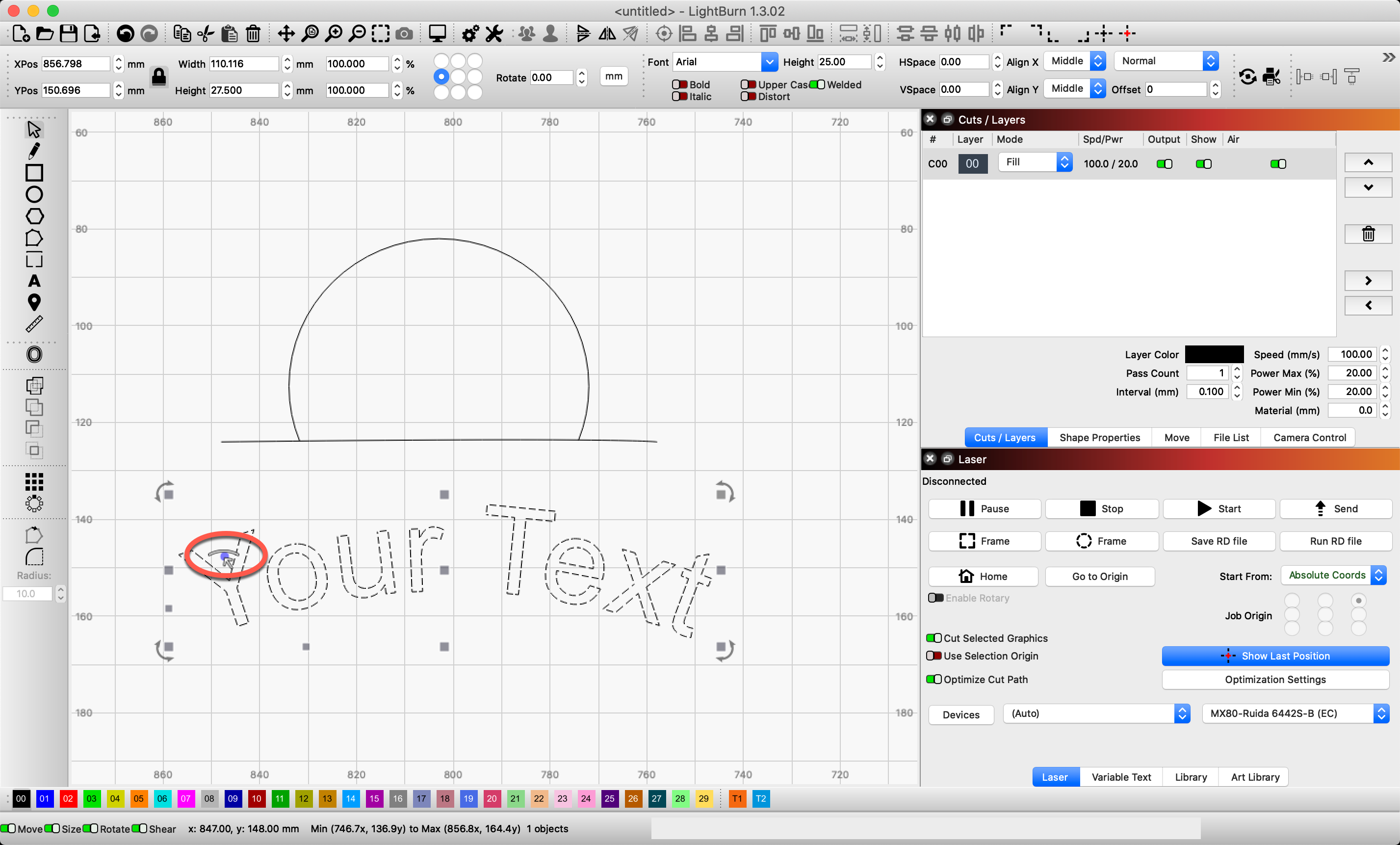

So cool. I need to make a name with bent text and I was trying to make two partial circles and I was going to draw two straight lines to connect. I’ll try to figure out the connect part.
If you are trying to produce a simple curve, there is also the “Blue Dot” when text is selected, which you can just drag to bend.
https://docs.lightburnsoftware.com/UI/FontsAndText.html#curved-text
