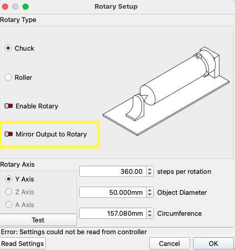

Trocen AWC7824 - Art work is mirrored using rotary function
Long time Ruida user with LightBurn, new to Trocen.
Lightburn has no trouble outputting rotary jobs for the Trocen controller, I enter the rotary settings through the controller panel and I can send to the machine and use the rotary. The only issue is that my artwork is sent mirrored on the Y axis. Yet the same art work engraved fine when I was engraving flat stock(not the rotary function).
Is there a switch I am not seeing to fix the output file?
For now, my work around is to mirror the artwork in Lightburn and send it to the controller that way. I was just wondering if there was a proper fix for this.

I don’t know if it’s an option for Trocen, but in the Rotary dialog there is a mirror switch.

I believe that isn’t supported in Trocen. I don’t have any Rotary options in Lightburn for that machine unfortunately. I tried some tests in LaserCad, the machines native software, and I noticed the same exact thing happening. Makes me think it is some machine setting or parameter I need to adjust for Rotary engraving only. I am still researching that option at the moment.
