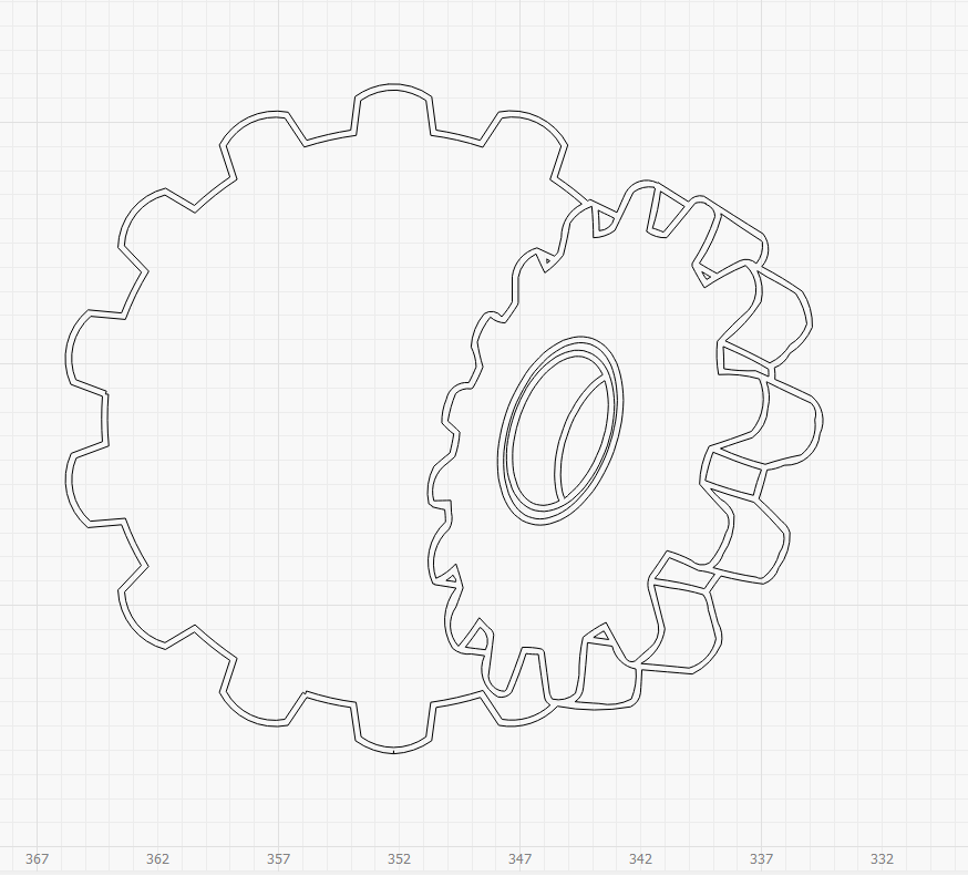

I’m trying to close all lines on an vector, I start with 67 and now I’m down 19. My end goal is to create an offset and change to fill so I can raster engrave instead of vector engrave, This should provide a better end result.Logo.lbrn (123.8 KB)

There are a series of shapes that can’t be filled unless they are duplicated and share borders with other shapes.
Just as an experiment, I brought your file up. I think it probably started life as a DXF file as there are so many inconsistencies consistent with that format. More than one or two duplicated/overlapped segments and a ton of non-connected segments that appear to be connected, but really are not.
I’m no whiz when it comes to this program, but I was able to make a properly joined/closed shape from the inner gear:
logo fixed sorta
The blue section is now one continuous line, which may not be what you want, but it’s easier to identify this way.
I’ll attach this mod for your viewing pleasure.
I learned a useful task this time around. The feature “close selected paths with tolerance” presents a dialog box suggesting to close with a line. You start with the “show me” button which selects those ornery segments, then use “close with tolerance” and close with a line. Use the slider to increase the tolerance until the line appears and the open shape count drops. It will then allow you to see exactly where the problem resides.

This design cannot be closed without a bunch of work. There are places in this design that will require double or overlapping lines which can cancel out the fill. It can be done, but each shape must be distinct and closed for ‘Fill’ to work as you expect.

Knowing now your primary purpose, if it does not involve de-focusing the laser, a fabulously easy method to make a fill shape is to import to Inkscape, set the stroke to the desired thickness and then use Path, Stroke to path, which will generate an outline for every component.
Since I like to try new stuff, I did just that:
Here’s the before shot of the file after importing the inkscape work:
A ton of overlapping segments representing line segments expanded by Inkscape but originating in DXF, as expected.
I hit the overall shape in spurts with the weld feature, but some of the crossing parts vanished, so I did those one at a time. Some welded, some required boolean union, the one below the weld icon. Even that did not work for the back ring inside the small gear, which was probably an artifact from DXF/Inkscape combined. A bit of add-node, delete line segments, join, join, join (trim glitched on one end, but worked as advertised on the other) and this is the result, with a 0.25 mm stroke:
