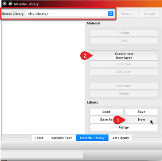

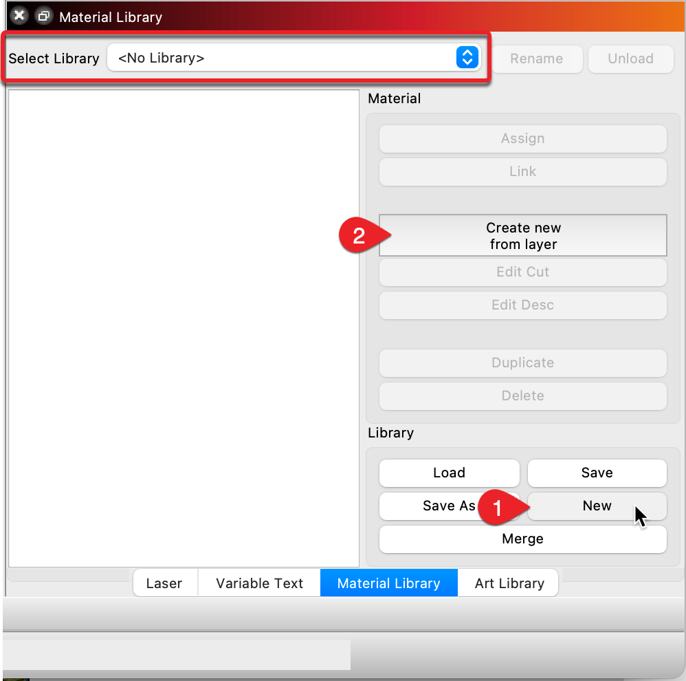

Welcome and thanks for reaching out. Below I share a few images of how to create a new Material Library. :slight_smile:
I do see we could fill out more information and include a few screencaps to better explain the process for creating a new library. I will report to our docs team.

You led me to see the required sequence.
At least the one sequence that is now working for me is:
  1. Make a “layer” in pane “Cuts / Layers”
  2. In pane “Material Library” …
  3. … Click “Create new from layer”
  4. … Click “Save”
  5. … Observe right side of pane “Material Library” changes
  6. … Click “New”
  7. … Observe new window entitled “Save Cut Library”
  8. … Enter full path name.
  9. … Click “Save”.
