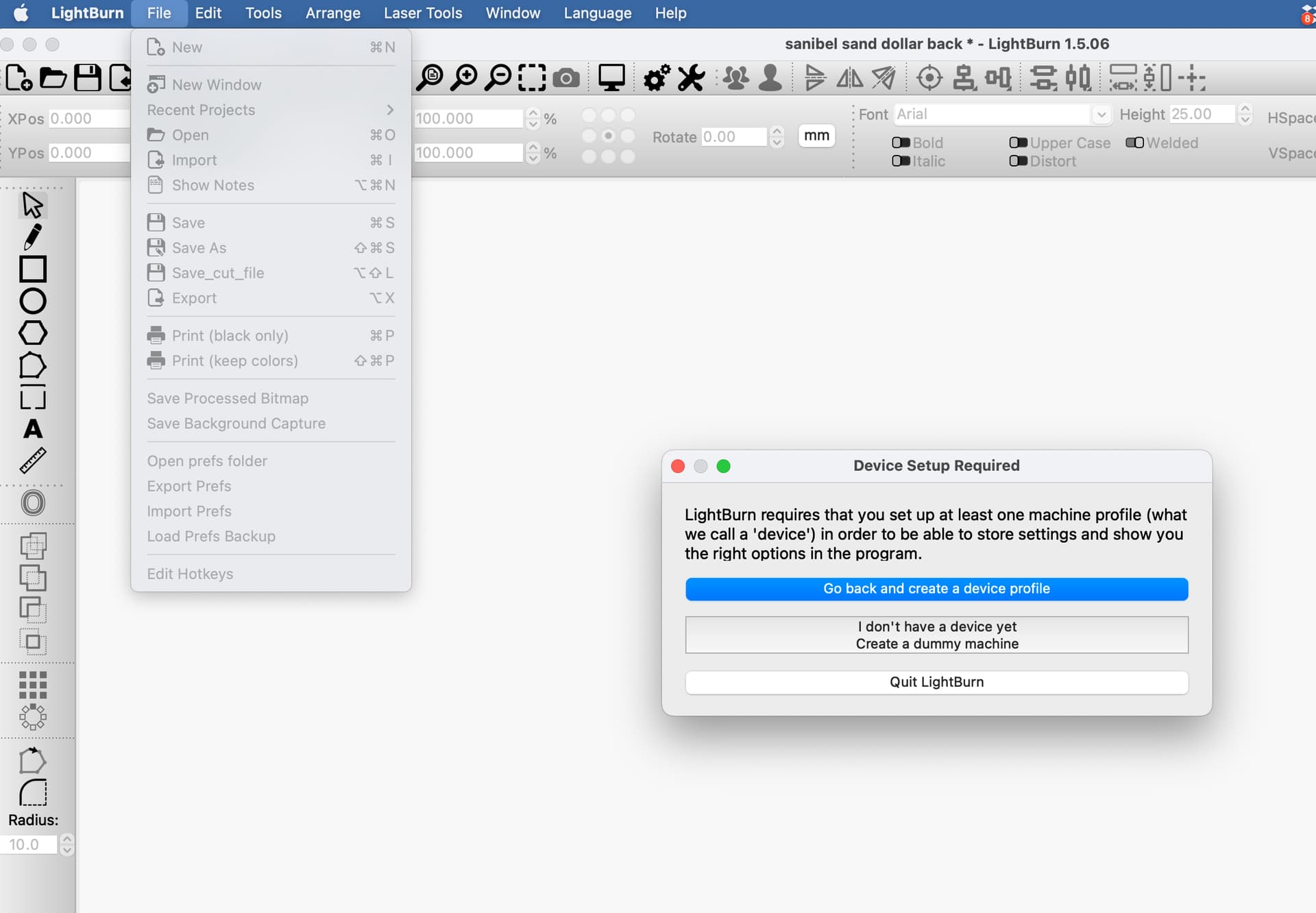

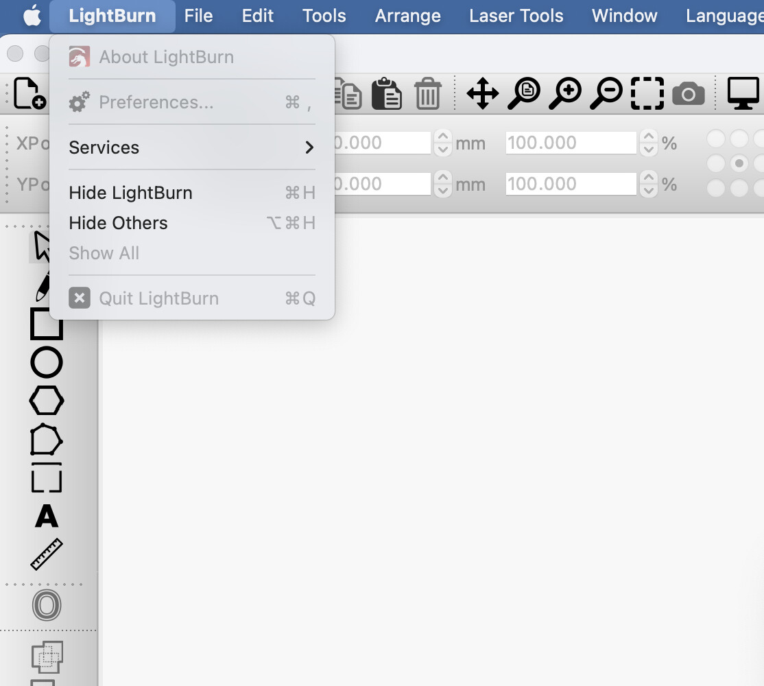

When I go into the file menu none of the choices are able to be chosen
Understand you are on MacOs and it can be slightly different but.
could you share your screen if you go to this menu
What is listed on the backup window?
That device setup window seems to be preventing me from doing anything.

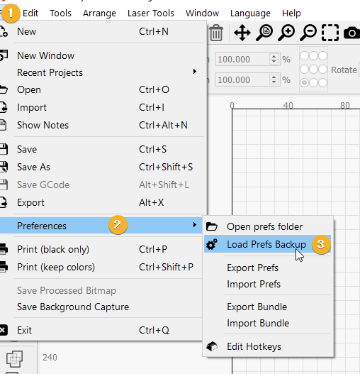

try this sequence please:
  1. create a dummy device
  2. File menu
  3. Load Pref’s Backup
from the list select the closes date you seem reasonable, maybe 1 week back
see if this helps
Alrighty it did let me load a backup pref set. Do I need to go in and create a new Device?
If you’ve selected a backup and the device profile matches the laser you’re using, then you should be set! Check your console window to confirm the connection has been made. Window>Console if you can’t find it :slight_smile:
