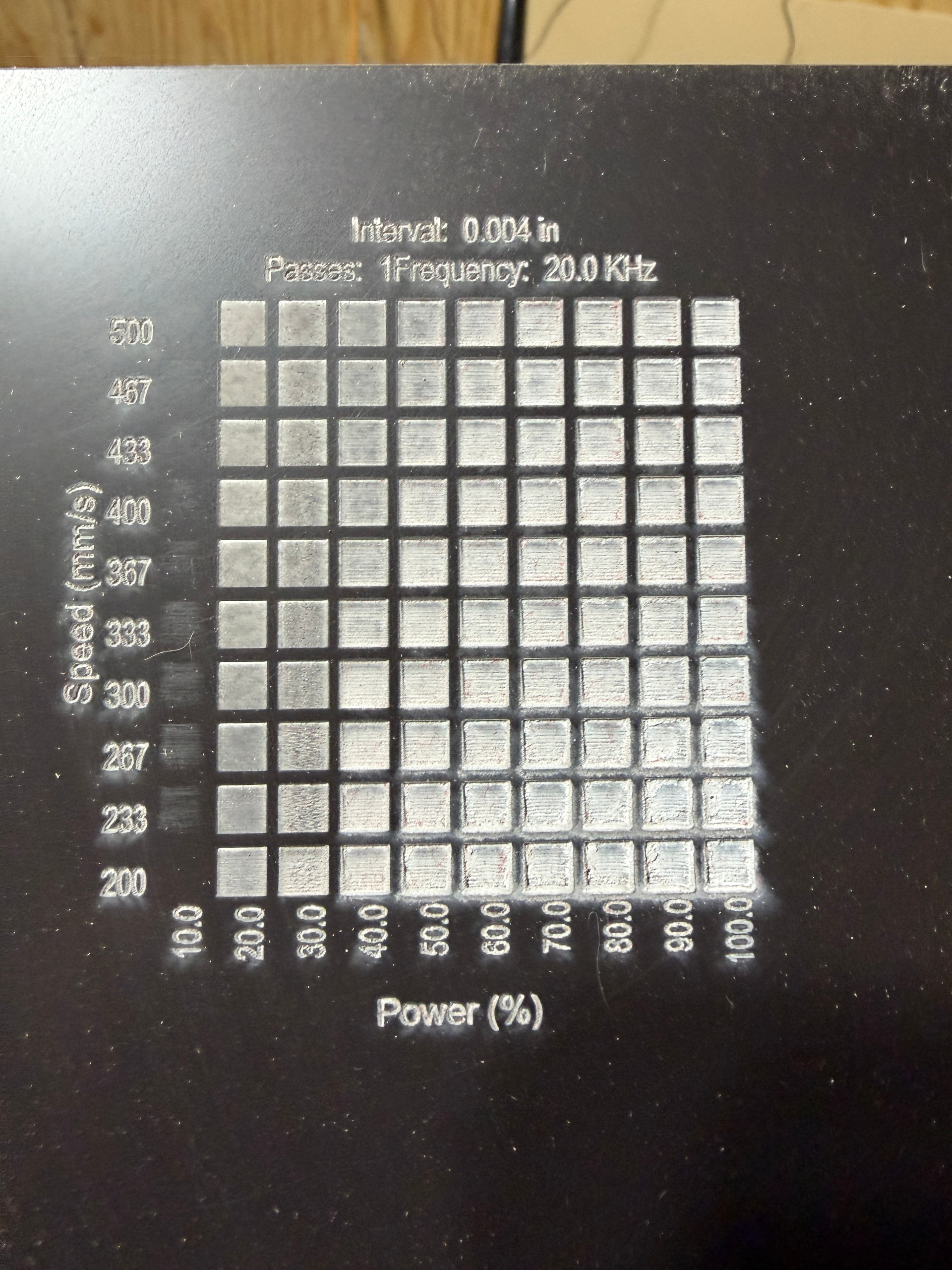

Hoping for some of the experts to chime in and help me out if possible. I have a Boss LS1630 105w laser. Great machine, works well for the most part but really struggling dialing in settings for some acrylic.
Machine is a Boss LS1630 with 105w tube, chiller, and air pump and air extractor. All the cuts were done using all of these things.
Material is a two tone, black on white 1/8th in acrylic from Houston Acrylic.

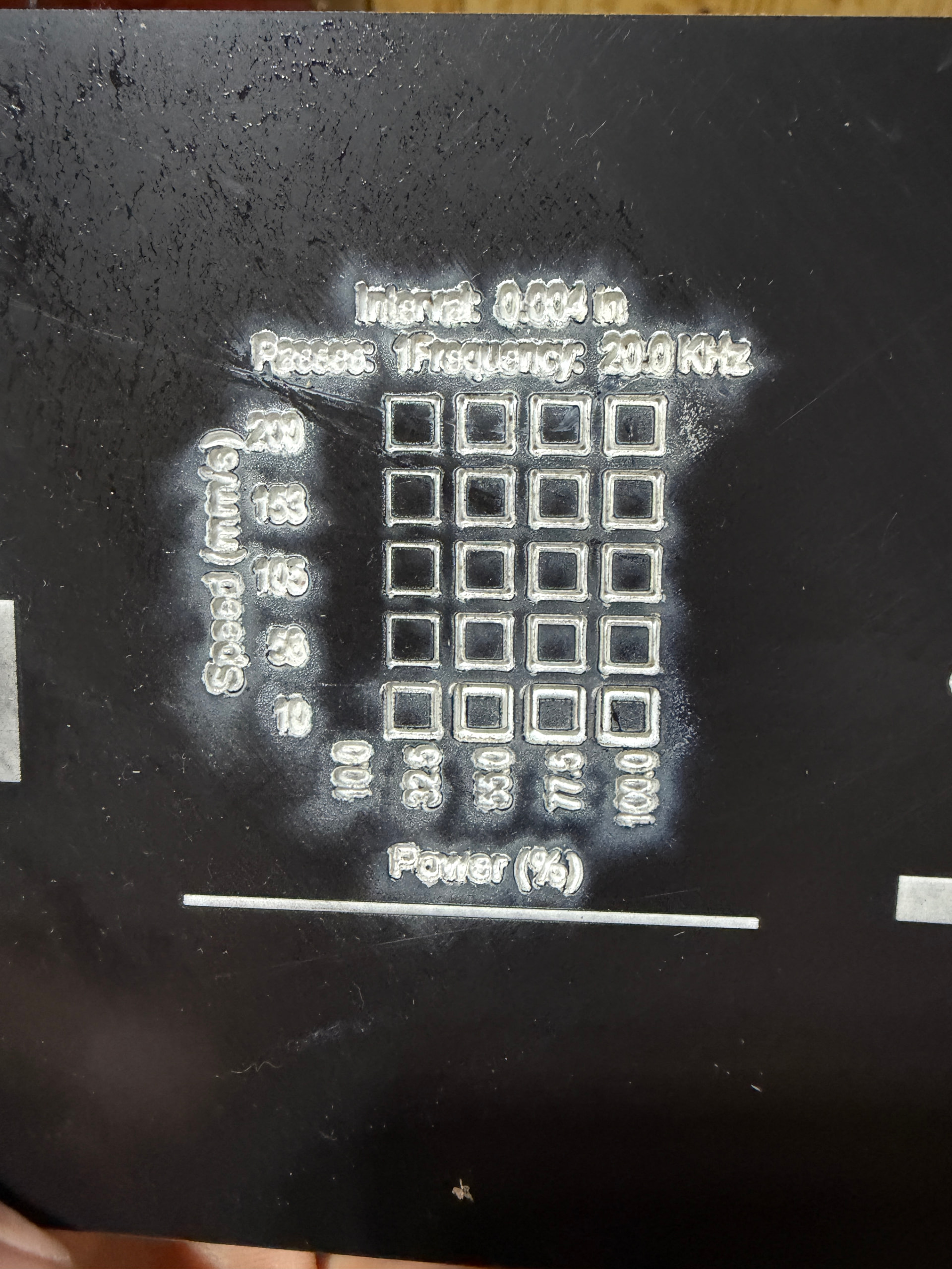

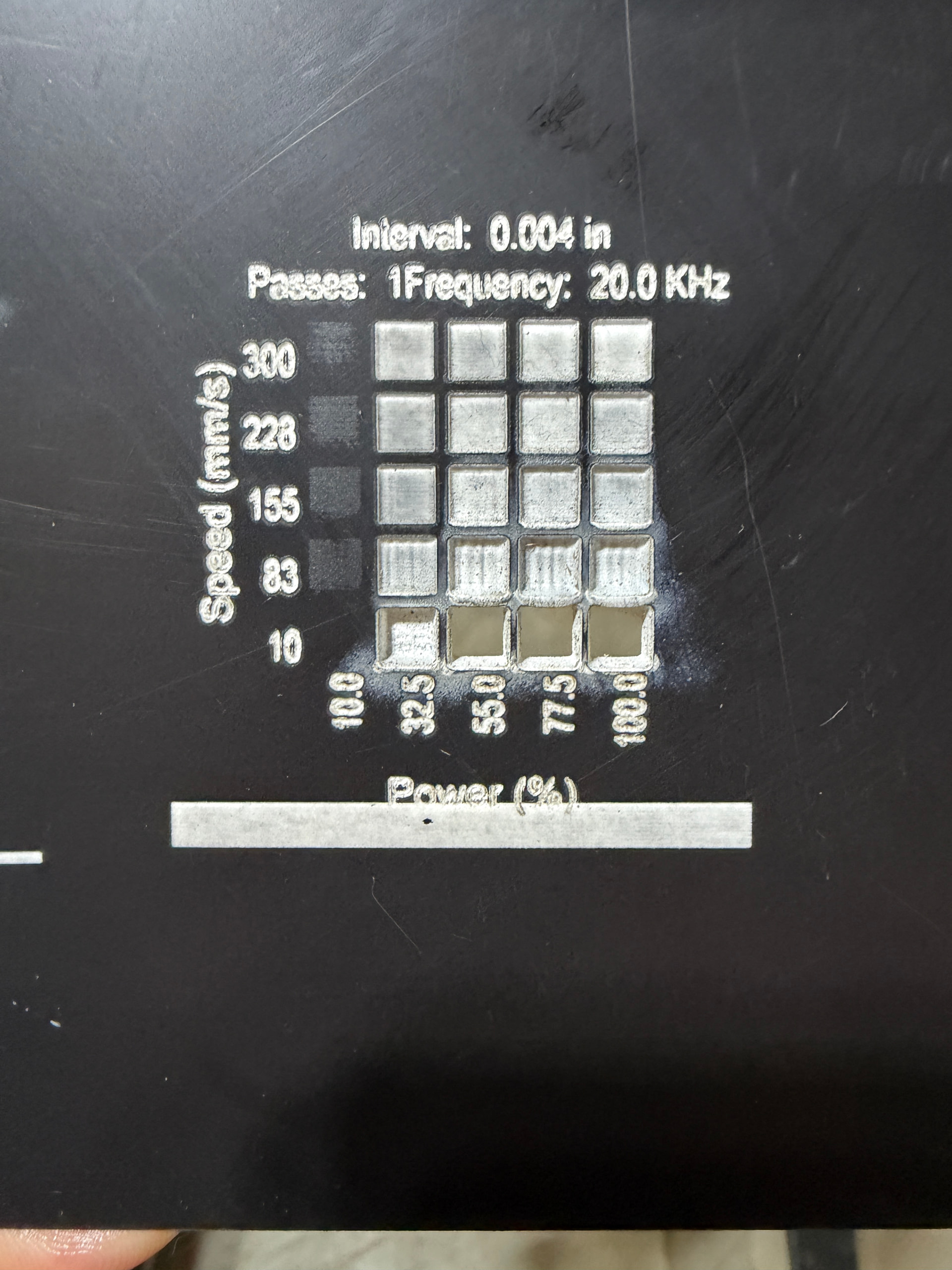

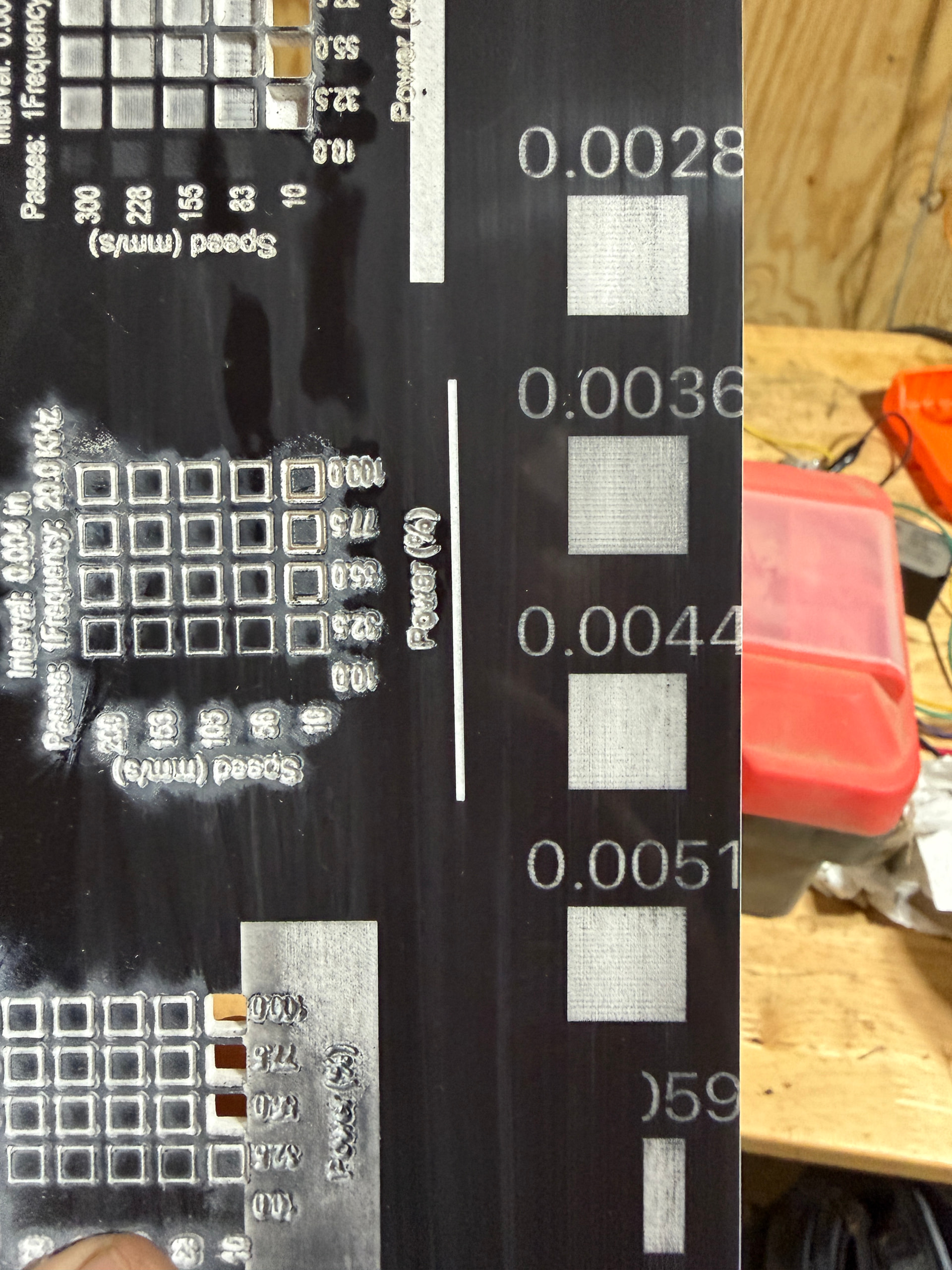

I am really struggling getting “pretty” cuts. Seems like no matter what I do the white always has a black tint to it after engraving. Also seems like I have to really put out some power to cut the acrylic. Am I asking to much? I realize black on white is not the easiest but I feel as though I should be able to get it cleaner. I have done material, focus, and interval tests in the pics below. The best ones to my eye just seem “ok”. Again, maybe the more experience would agree or disagree on me asking to much. I have tried cutting with the masking left on and off. As well as putting masking tape over the cut. I have tried turning off the air pump which does improve the cut somewhat but just puts soot on everything. I have to heavily clean every cut if I turn it off. I have tried cleaning with compressed air, dish soap and water, and isopropyl alcohol. Again, the results are “ok” in my eyes but maybe Im being unreasonable. Lol
Thank you in advance for any and all help!
Interval Test
Material Test Engraving
Material Test Engraving 2
Material Cut Test 1 (at 2 passes I could cut through at 10mm/sec and 55% power.)

For engraving, good reuslts from a 100 W machine will require more speed and less power than your tests show. My 60 W tube fires reliably at 10% and yours is on the edge, so run a Material Test from 10% to 20% with speeds from 200 mm/s to 500 mm/s (or faster, if it can outrun mine).

The terrible cuts in your test suggest the beam shape isn’t quite right. Verify the focus by running a ramp test, then a Material Test around the power & speed I use.
If the cut remains terrible, the tube may not be resonating in TEM00 mode. This discussion covers what that means, what to do, and what to look for:
