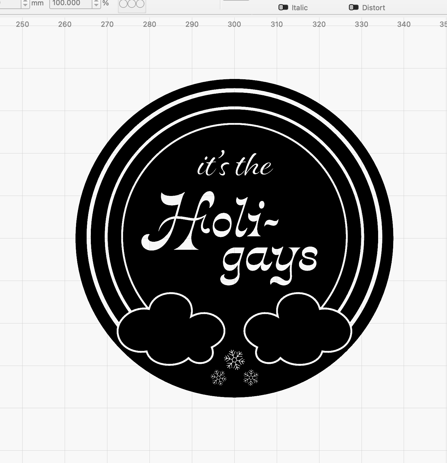

The issue I am running into is when I import the file as a .ai, the rainbow rays are filled as they are supposed to be (they should be colored in). They are a compound path. But, when I export them as a .svg and import the .svg into Lightburn, it does not read the compound path as one, and instead creates errors and reads them as two objects.

Can you explain it a little more?
When I import your file and save it as an LB project, I only have one layer with all the content.
test8828b.lbrn2 (119.3 KB)

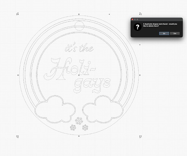

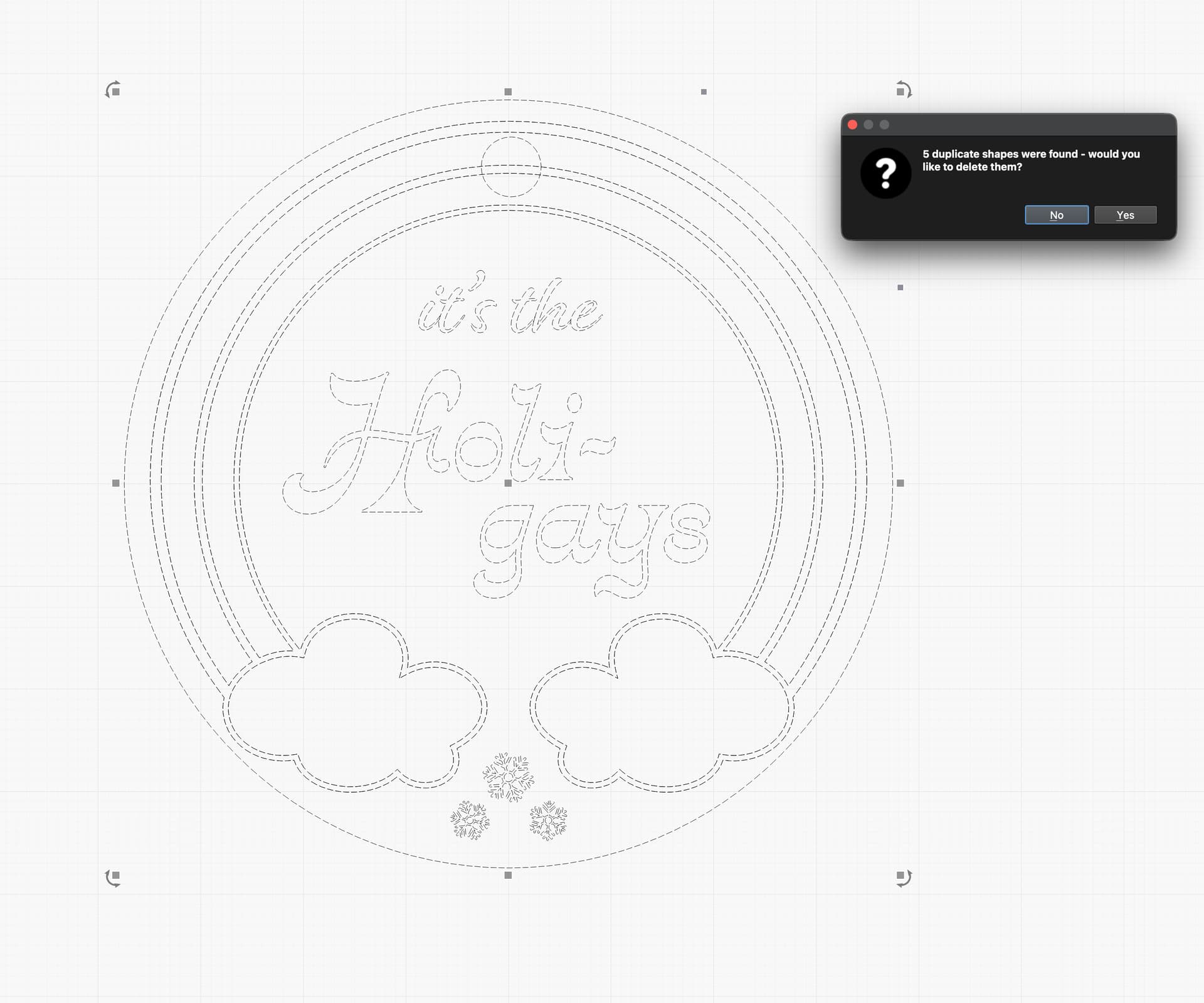

Hi Shelby - I imported the attached .svg and noticed that once ungrouped (Ctrl+U) there are multiple overlapping lines. If I then select all (Ctrl+A) and go to Edit > Delete Duplicates, it will remove those 5 overlapping lines.
When I then switch the view to being Filled (under Window, in the toolbar) I get this - is this closer to what you’re after?

I’ve also found those duplicates… :slight_smile:
Awesome thank you! Is there a reason that the .svg would be creating over lapping lines when the illustrator files don’t have those lines? Thanks for your help with this! I truly appreciate it!
Generally it’s because there are legitimate duplicates in the design file. There are nuances to the workflow from a design program (a mask-heavy design tool) to a vector editing program like Lightburn, so there may be a second set of lines in your chosen design tool.
…same opinion like @Colin
I only “found” your SVG but not the AI ​​file, so I can’t comment on that, but my best guess is that the duplicates come from the original file
