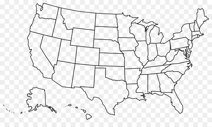

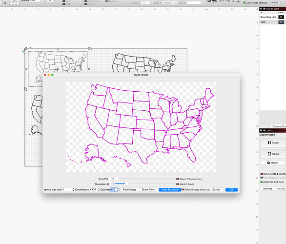

I have messed with a lot of settings here and am not getting the results I want in image trace. I have the original file and my settings. The first one came out individual polygons. The second attempt was using the clear boundary button, and it gave me a thicker “pixelated” image. Third, I tried to reduce the threshold and lost a lot. The 4th attempt was “sketch” trace on and tried to max out the optimization. I am still getting double boundary line. Is it a poor quality image? I have traced
US trace v.1.lbrn2 (533.4 KB)
.png files before with decent results.
I would try Inkscape, Lightburn can’t do a center trace unfortunately.

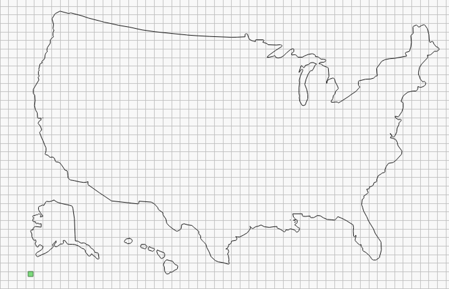

I still have to cut the USA and laser the states at a lower power. After I optimize this, amI Abe to create a perimeter on one layer and the inner lines for state on another layer. I have never done this.
The way I would do this is use the Offset Tool and create a very small offset of the map, selecting Outer Shapes Only, then move the offset to a cut layer. But until you have a map without breaks in the perimiter, you cannot achieve that. This is what I came up with using a 1mm offset. It could be fixed with Node Editing.
You still need to fix all the state lines, but this gives you an outline to cut.

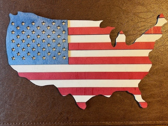

Here’s one 2 layer flag i just finished with the whole design but not individual states. For your next flag project. I actually started with the file i sent this gentleman earlier but thought the outline was too busy so i did this one with a little cleaner outline
United_States_Outline_Flag
American Flag W_Outline V2 9 Final.lbrn2 (337.2 KB)
Thank you so much. I had to tone some areas down as well. As I have been cutting, I notice that smaller objects can get messed up by the kerf on the next pass.
