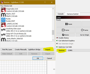

Thank you for reply. shop locked up for tonight. I have no limit switches. Will check G0X0Y0 tomorrow and let you know. I have ANyDesk Installed. Are you willing to log into my computer and help setup the cnc remotely?
Do you have separated settings/firmware for laser CNC operation?
If they are the same change a few things to start after reading the above document.
Type the following in Lightburn Console window pressing Enter after each command:
$10=0
$130=1000
If your laser head moves to front left click devices then Import LaserCNC_1000x1000_Front_Left.lbdev (2.7 KB)
After things start going you may need to fine tune more GRBL settings.

If your laser head move to back right import this one instead
LaserCNC_1000x1000_Back_Right.lbdev (3.0 KB)
Report back if you have more issues.
