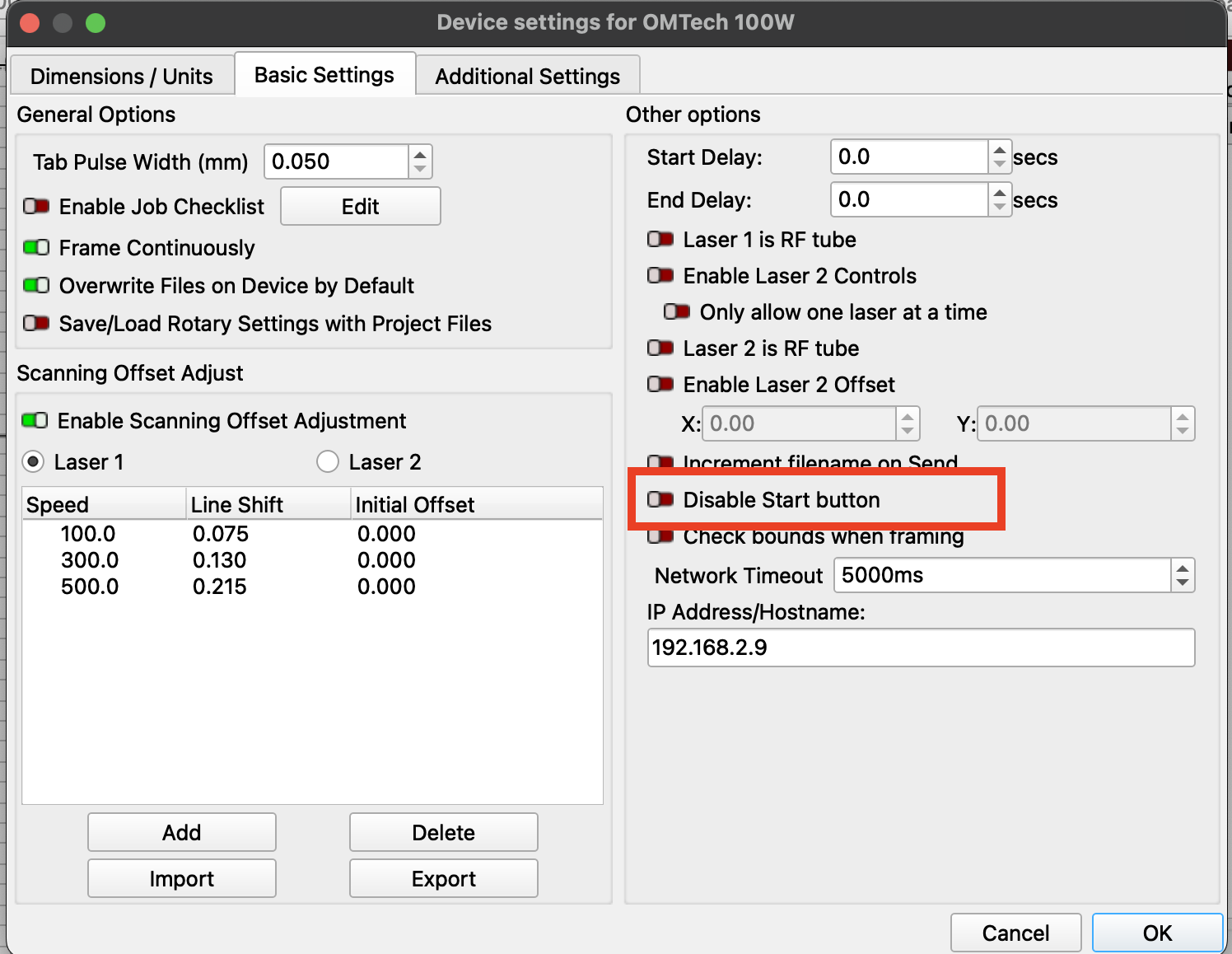

I am having trouble doing material testing for engraving tumblers as on the Thunder laser Bolt Pro 32 I have to send the file to the machine to engrave on the rotary and the Thunder Rotary set up apparently doesn’t let me just start with the start button. Is there any work around so I don’t have to build several material test files myself?

Do you possibly have the start button disabled?
