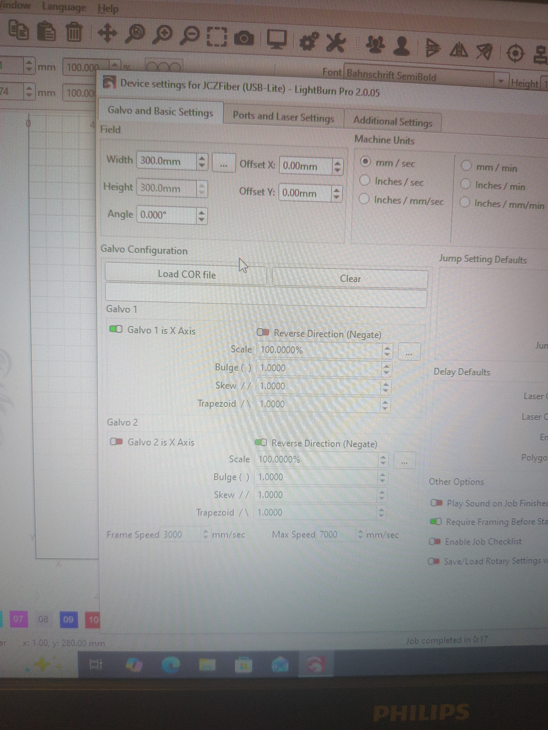

Laser Tools → Rotary Setup, which galvo axis is assigned to the rotary (X vs Y). This must match the axis that physically rotates the chuck.
Device Settings → Galvo & Basic Settings: try Reverse Direction (Negate) if it is already toggled; if not, try turning it off (share a screenshot if unsure).

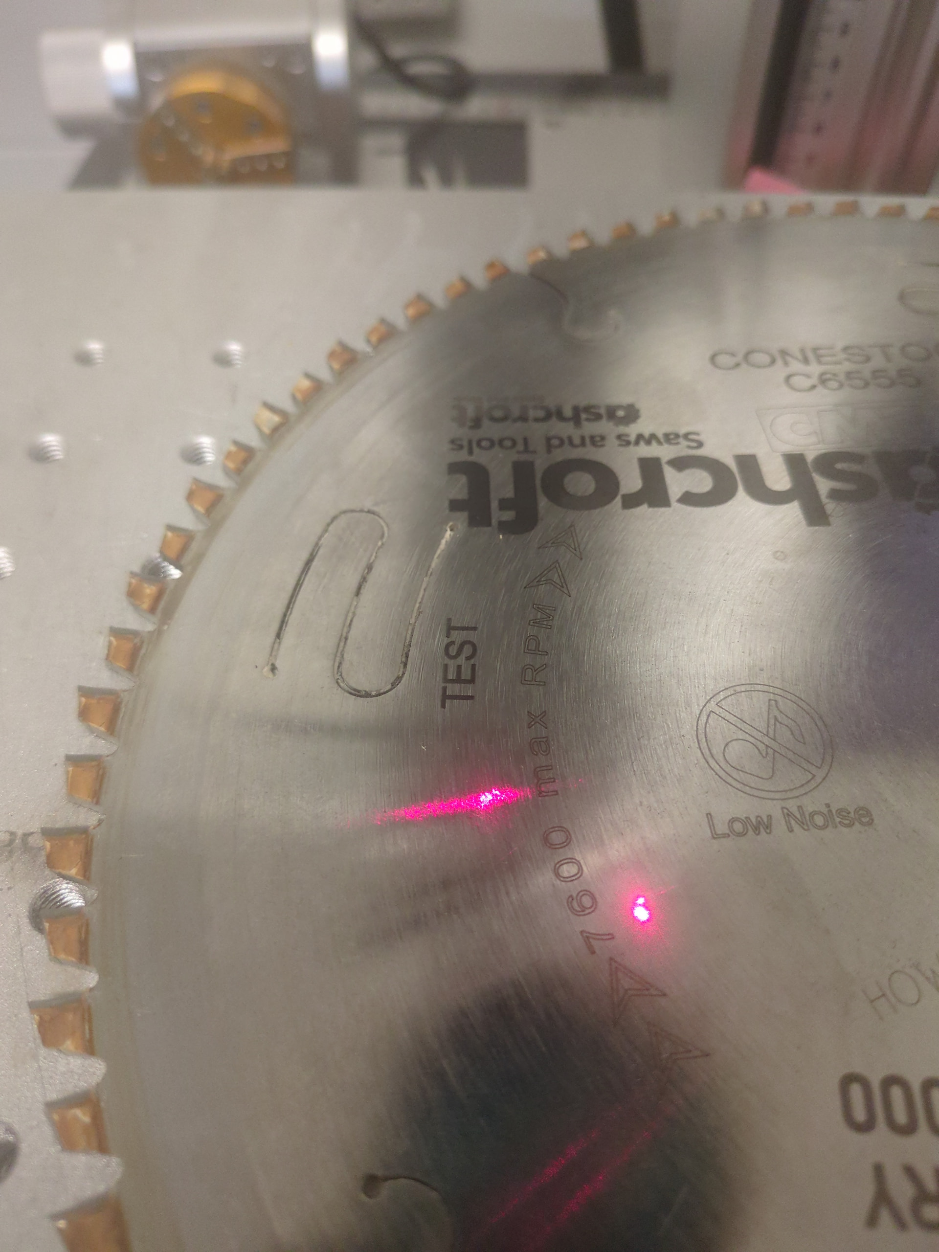

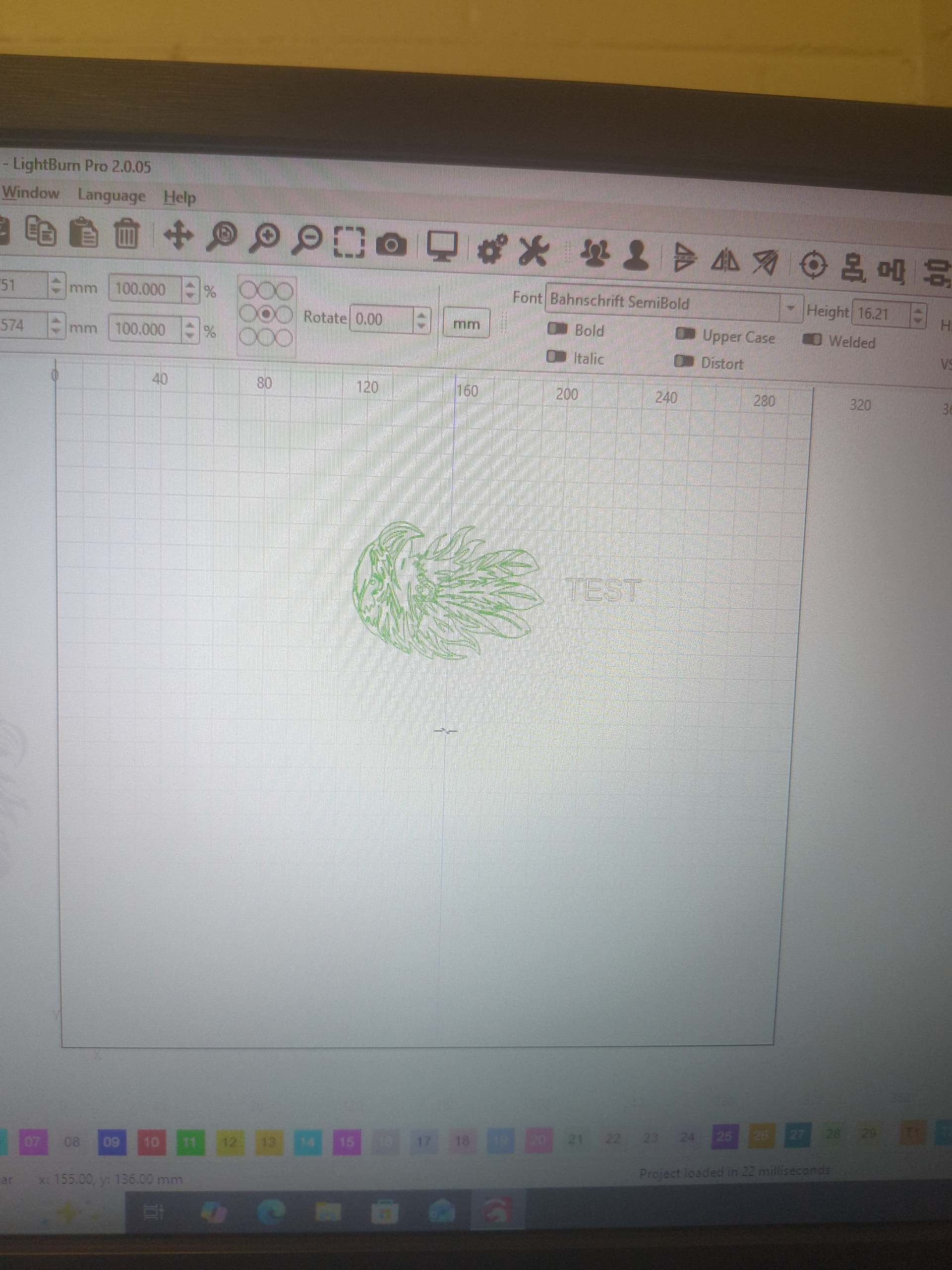

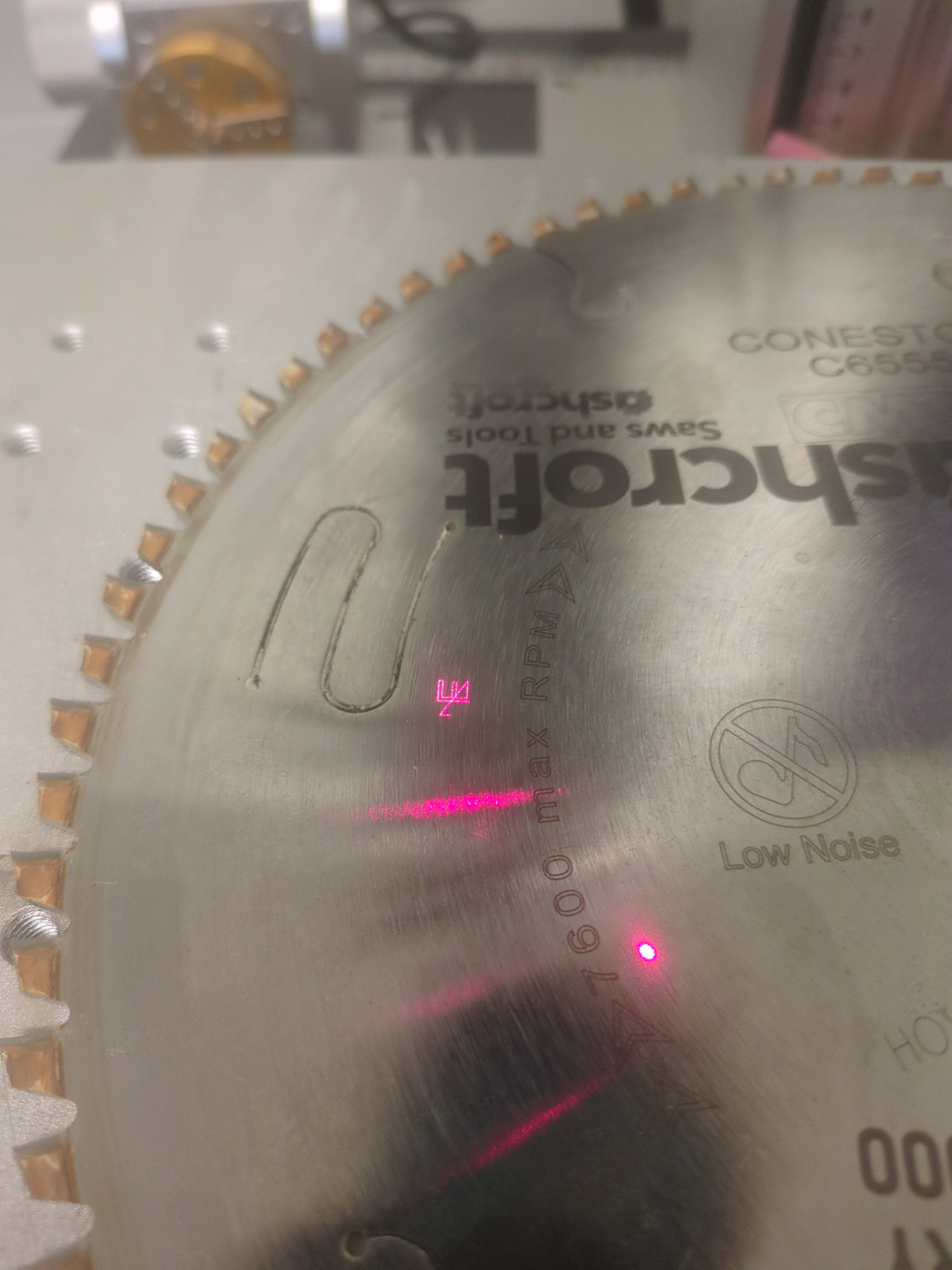

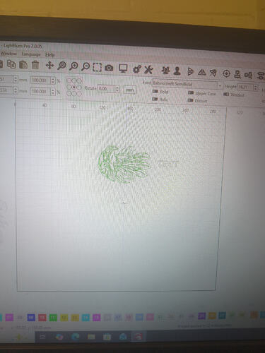

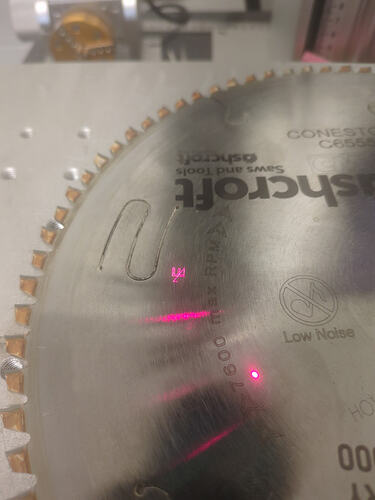

Ok so I have tried so many settings and nothing works. I will add pics of what I am seeing. Maybe something will trigger someone’s kind on why this setup isn’t working.
These are the only settings I can get to work close enough. I know I didn’t do the box like you asked but I figured this was close enough
“Close enough” only works in horse shoes, hand grenades, and atom bombs. Computers prefer “really close enough”. :joy: .
I figured drawing a “box” wasn’t going to help as much. All my other machines I have no problem with, be it diode or CO2 but galvos are kicking my butt!
