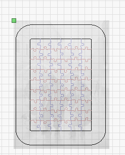

I have gone through much birch wood trying to figure this out. When I cut the puzzle, the pieces are two small and when the train is cut, I am left with thin outline of pieces.

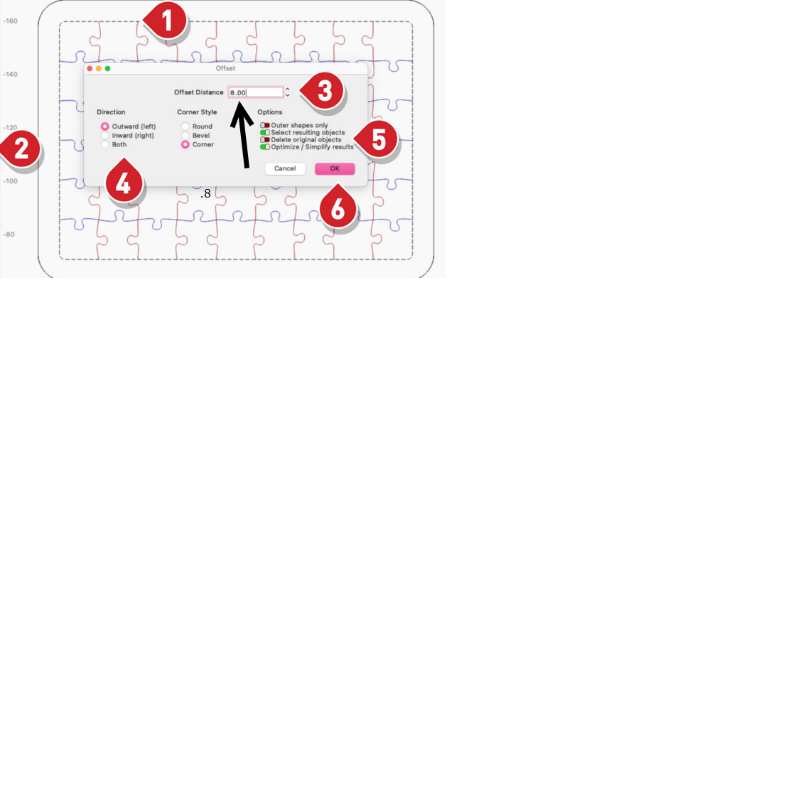

Changed Offset to .8000

Apply Mask to Image is grayed out?
Apply Mask
I can’t seem to see image through puzzle to trim off excess.

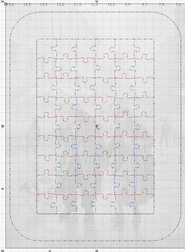

When I imported the puzzle, it shows horizontal/vertical lines in multiple colors. Should they all be Black for cutting?

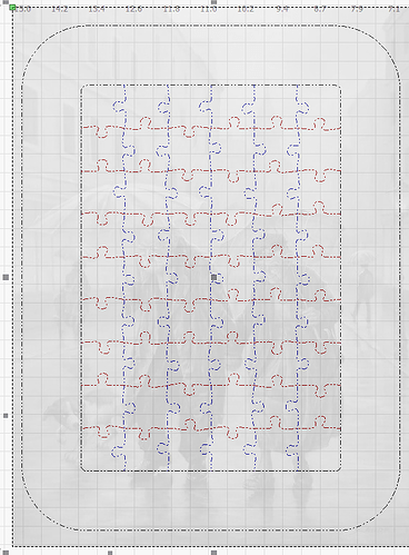

Back to the train. Here is what is happening…
Your lines for the puzzle pieces are DOUBLE lines. Your laser is cutting both of them. Need to redesign image to a single line instead of the double line and it will cut fine if these are just free-form puzzles.
It looks like the designer was going for you to glue the framework over a solid outline (as shown in your photo) and then the cut out pieces will fit in the frame. This is typical for a puzzle for younger children to give them assistance.
I was thinking of gluing cutout piece to back piece but it’s pretty fragile. I guess that’s the way I will go.
