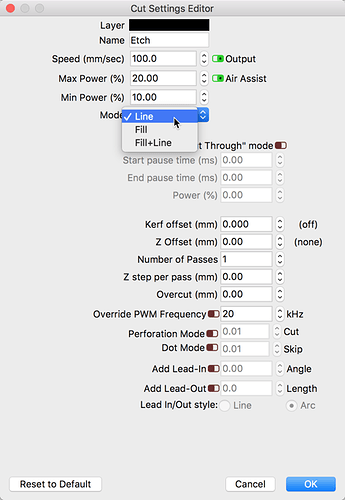

Need help , new laser and new to the program. I’m trying to do cut outs …
I can get it to engrave but not do a full cut out . It’s a 130 w laser and I’m cutting 1/4 plywood but cut mode is “ line “ I just just need to change a setting

We changed the words we use to help with users that are new to lasering, like students. In LightBurn, ‘Line’ = Cut, ‘Line’ = Mark, ‘Fill’ = Scan, ‘Fill+Line’ = Scan then Cut.
Double click the layer in the ‘Cuts’ window to expose the ‘Cut Settings Editor’ and select ‘Line’.
