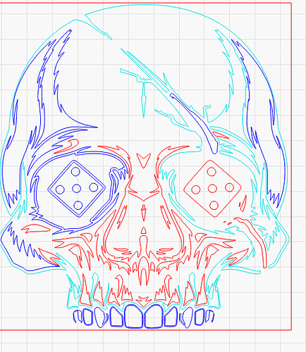

I started out by tracing the image to get an outline of it, but there are so many lines it got confusing. The outline ran into the middle of the image. I removed a lot of smaller design lines to help with clarity. I have attached my lightburn file for reference, but I am in the middle of working on it, so it’s kind of a mess. The light blue is the outline. The dark blue is Fill and the red is left over from the tracing. I would like to connect some of the light blue to make more of an outline, but I am not sure how.

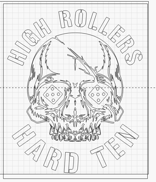

I guess I’m a bit confused.. You graphic traced properly, here is the work area.

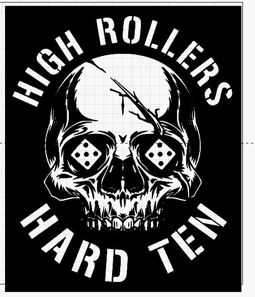

If I turn on fill, it looks like the original.
Guess I’m missing the problem.

Let me see if I can explain. Some of the areas are fill areas because they are filled shapes. But the outline of the skull is so twisted around the skull that it leave areas I can’t fill. How do I connect some of the open areas so I can use fill to fill them in? Is there a draw function that will allow me to close some of the shapes?
Does that explain it better?

I am posting a picture of the skull from my LB file. The dark blue areas are where I will fill. The light blue area is the outline of the skull. The red areas you can ignore. I haven’t gotten to them yet.

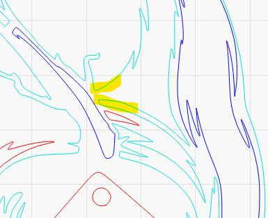

The light blue section is all one line even though it travels all over the skull. I want to turn some of the light blue areas to dark blue so I can fill them, but the lines don’t connect in ways in which I need them.
I am posting a closeup of one of the areas I am talking about. This is a closeup of the light blue area above the red die. I would like to connect the light blue in the highlighted areas so I can turn that section of to fill. I hope this helps.
