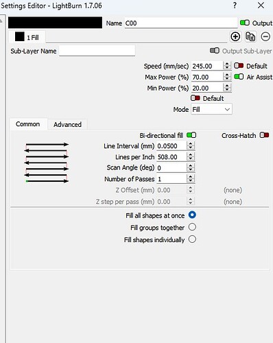

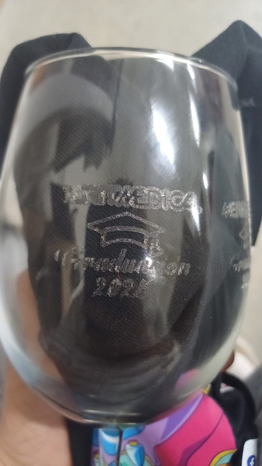

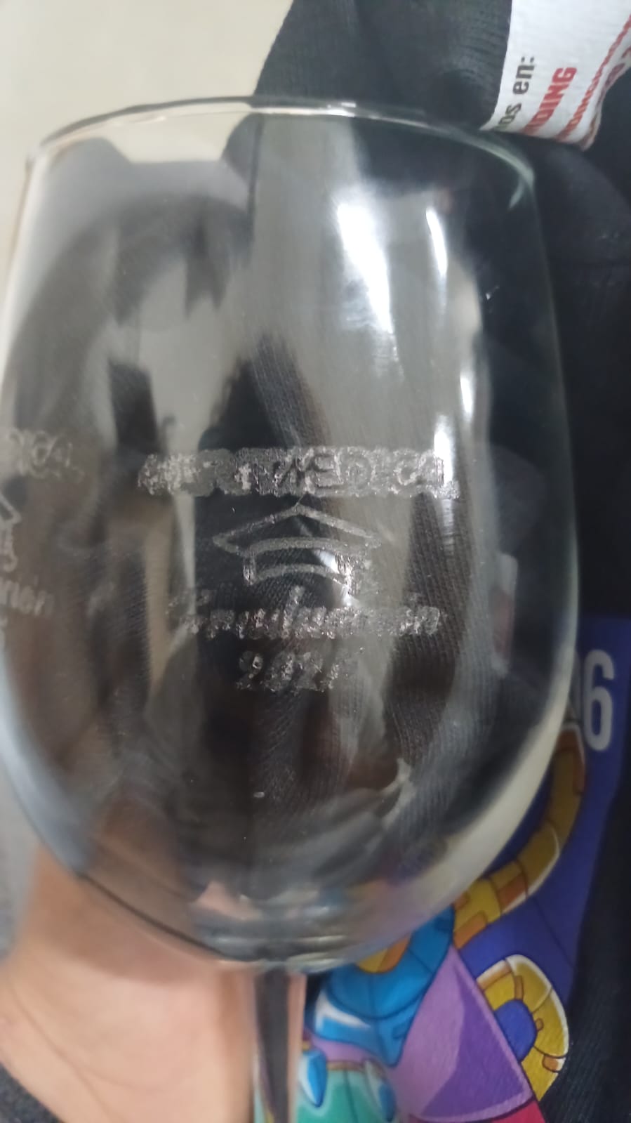

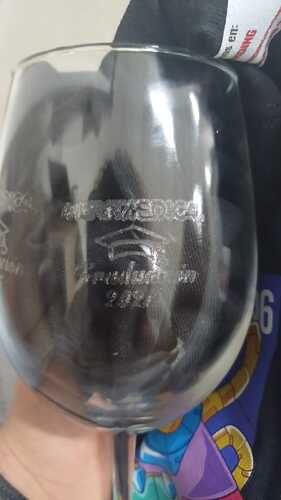

Hi! I’ve been trying to engrave glass cups for several days, but the result keeps coming out rough or sandy. Does anyone have any recommendations?
I’m using a generic CO₂ laser, model 1610 (1600 × 1000 mm, about 120W).
Here are the settings I’ve tried:
Unfortunately CO2 is going to have a hard time with glass - it’s not the right wavelength of laser light to directly mark glass without fracturing it as you’ve seen.
Some people have reported a layer of paint or similar can improve the result - but for glass usually you want a UV laser source, and some have better luck with Diode lasers as well https://www.youtube.com/watch?v=tcvGC18RZS8

haven’t tried that yet. I’m not really sure if the power is too high, but when I use less than 30%, it doesn’t engrave at all, it just blows air.

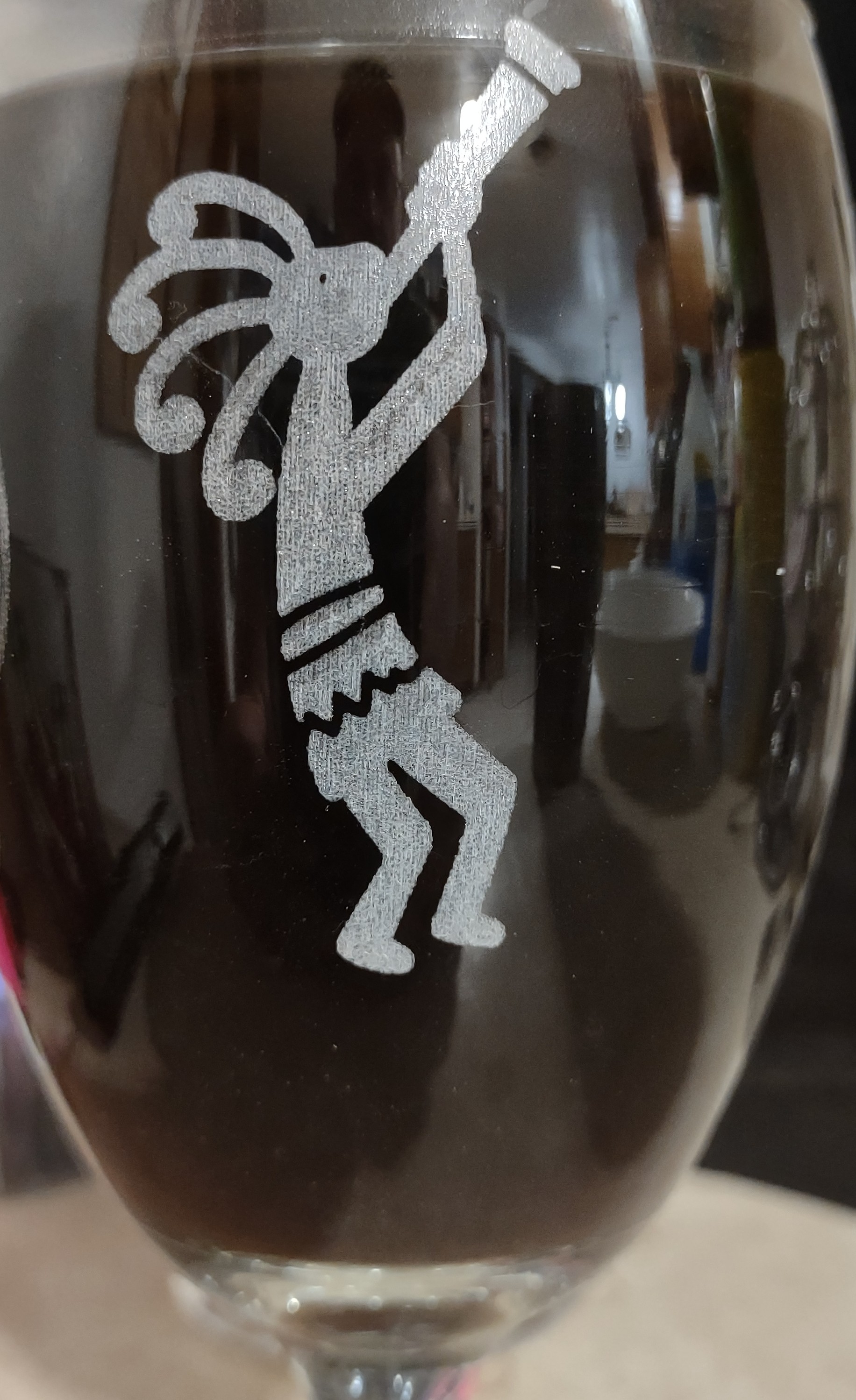

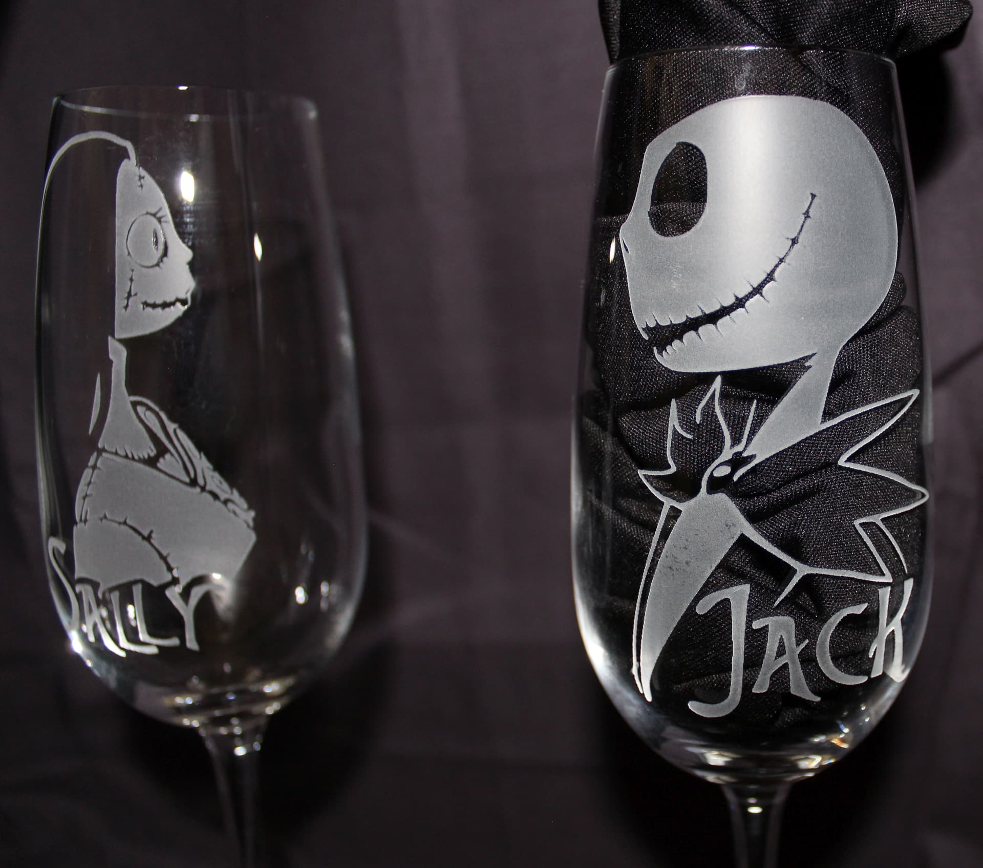

I use rayzist photomask, then use fill to burn it off. Then I sandblast it smooth.
