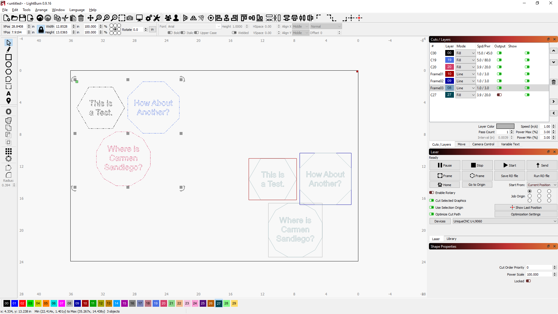

You could create a copy of the project (either in a new file or to the side of the work area) and set all of the layers to the speed you wish to frame them and the power low enough to illuminate the laser without burning the wood. Then just run the job with the alternate layers for framing. This could be a use for “Cut Selected Graphics”.
That is kinda how I currently do it. I turn off a layer and a shift-frame to see where it is going to land and the I repeat the process on the other layers.
What does it mean to turn off a shift-frame?

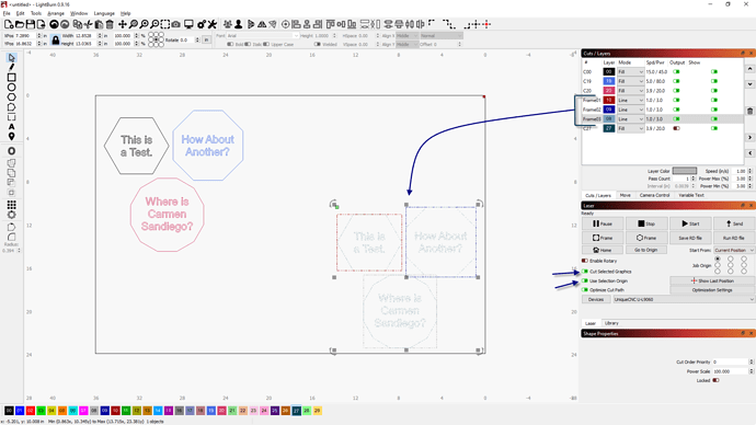

The method I described will do exactly what you’re asking if on this second copy of layers you draw a box set to the layer, set it equal to all of the parts of the layer:
Here is a job of Cut Selected Graphics that would just “frame” each object:
Note how I have enabled Cut Selected Graphics, Use Selection Origin, and Start From Current Position
Then selecting the actual objects for the job:
