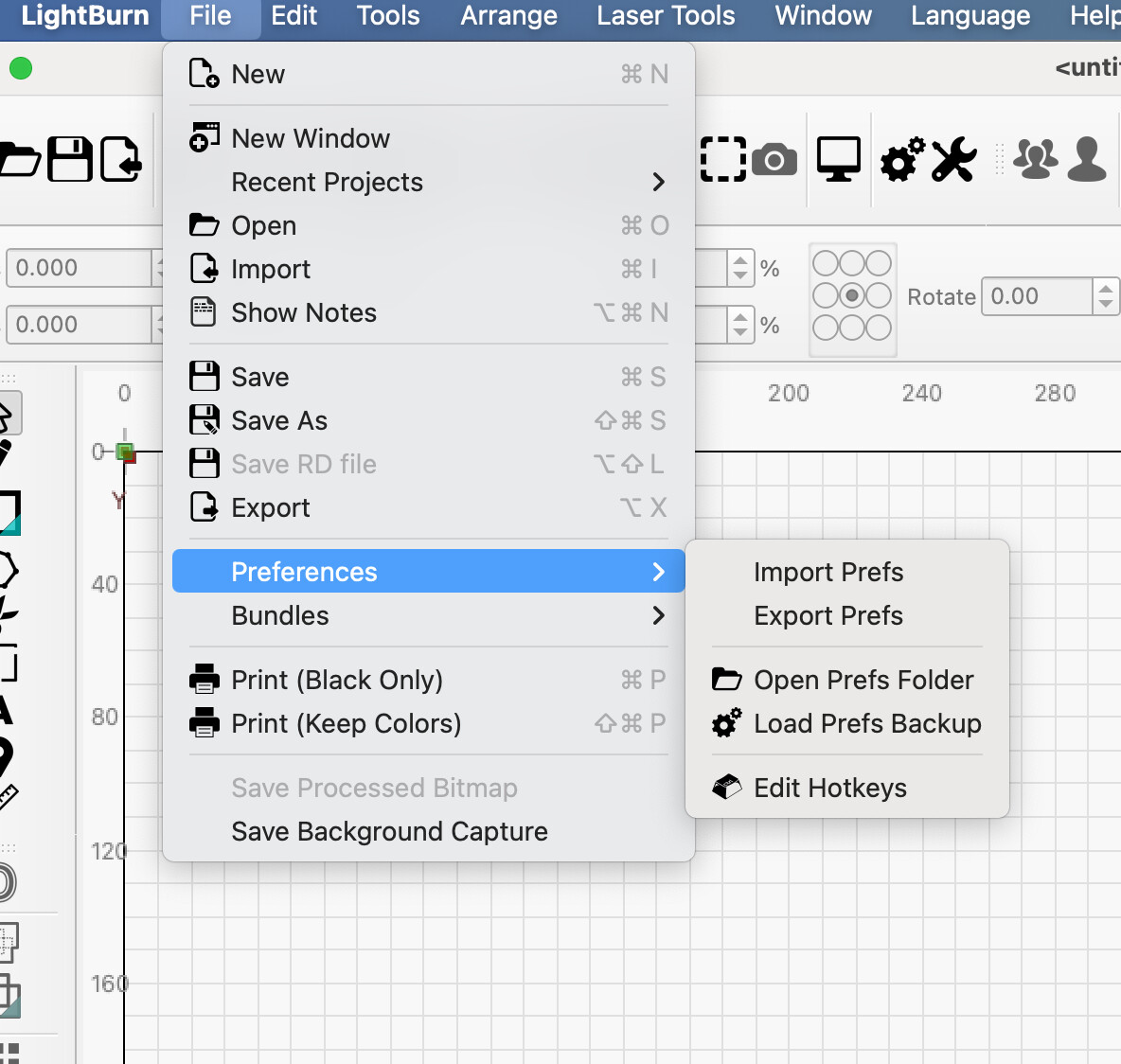

Find and use LightBurn’s “Bundle” feature, select all options and export them to a safe place. Later, if needed, just import them back.
You can also “settle” for just installing the “machine preferences”
