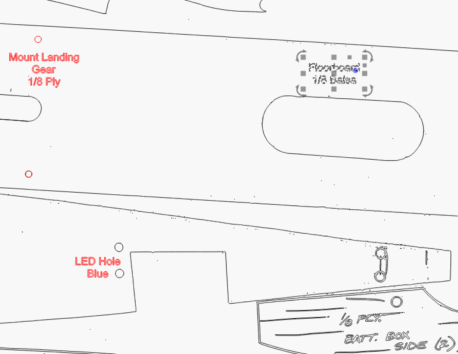

Trying to keep all "TEXT" on a separate layer
I am new to Lightburn and Lasers. I have a ACMER P1 10 Watt and am running the current Lightburn version (1.7.07). I do almost all my work on an iMac M4 running Sequoia.
I have some drawings that I am cleaning up in Lightburn and I did so by tracing. Some of the text was hand written on the original document and during cleanup became illegible because some of the text had lines running over it that were deleted.
All the text that is showing in RED is associated with layer 02 and for some reason I did something wrong and the text that is in grey on the right “Floorboard 1/8 balsa” is not going to RED and layer 02, it is in Layer 00. I tried highlighting the grey text and then selecting layer 02 but it doesn’t change it. And by the way layer 00 is in “Mode: line” and so is 02.
I hope that makes sense, and I appreciate any help you can provide. My goal is that all the text on the parts to be cut would be lightly engraved on the part.
It is 100% easier to help you if we can see what you settings are, and even better if you can upload a small sample of your file for us to poke around. Use the image button to import your file into the chat.
How are you assigning the layer to layer 02? Note that this is done by first selecting the object you want to change, then using the layer buttons typically at the bottom of the main window. Based on your wording it sounds like you may be selecting the layer in the Cut/Layer Window.
Brian, thank you. When you said “sounds like you…” all I had to do was highlight the text go to the bottom and it now belongs to the right group. Problem solved.
Jim, thank you for your help and if I need help in the future I will certainly upload what I am working on. Thanks to you I now know how to do it. Appreciate the help.
