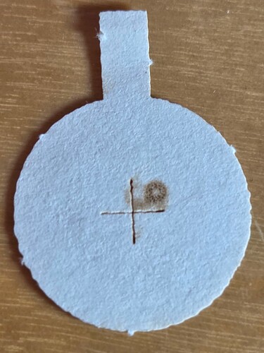

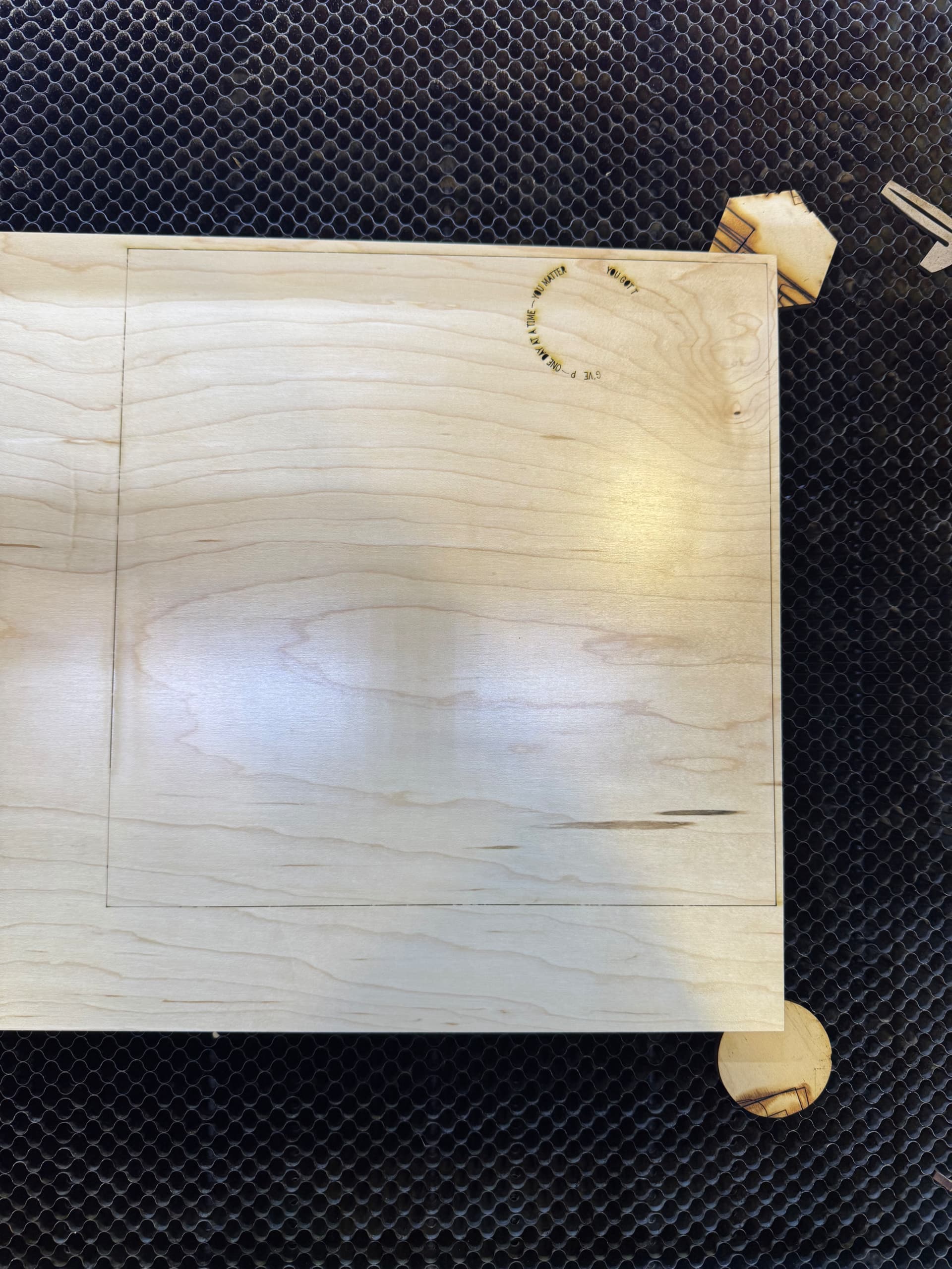

Didn’t help. Replaced the controller on my machine (per TTP) and it was good again. For 6 weeks (and about 2 hours of use). Yesterday back to the same thing. We changed the speed to 300 on a large 10x10 square shape to see what it does. Max power 12. Min power 6.
The lines still show, but 2 out of the 4 corners it’s cut right thru.

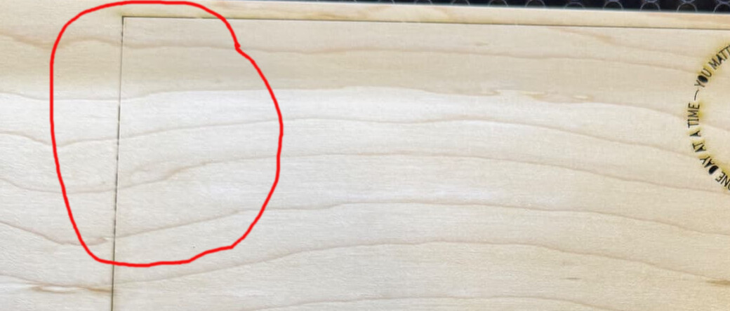

When lasing wood, it’s normal see variations within the grain. When I examine yours, I see variations in areas I would not expect as the grain doesn’t change that much. I circled the area, there is little variance in grain compared to the lasers damage.
