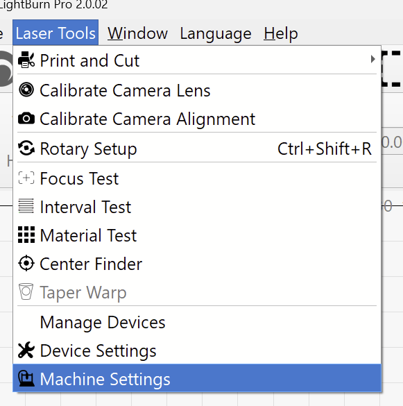

Trying to turn on the Air Asist I go to edit and the Machine tab is not shown
I’m a new user and just fitted an air upgrade to my new machine and with a lot of help from UTube.
I need to tick the toggle for air assist however the machine Tab is not in the edit dropdown list..
The videos are all more than two years old. Can someone help and inform me where it has been moved too? Cheers Jeff
You mean to set the M7 or M8 command? That’s in device settings. The normal toggle is in layer window.
For version 2.0, we moved the Machine Settings to “Laser Tools > Machine Settings”
I’m forwarding this to the docs team. Thank you!
Thank you for the help .
Cheers Jeff
I have the same problem but In machine setting i haven’t references to “air assist”
That’s correct. This is not a firmware setting. What issue do you have exactly? You can change the command in device settings, but there’s not more to do. The rest is hardware.
