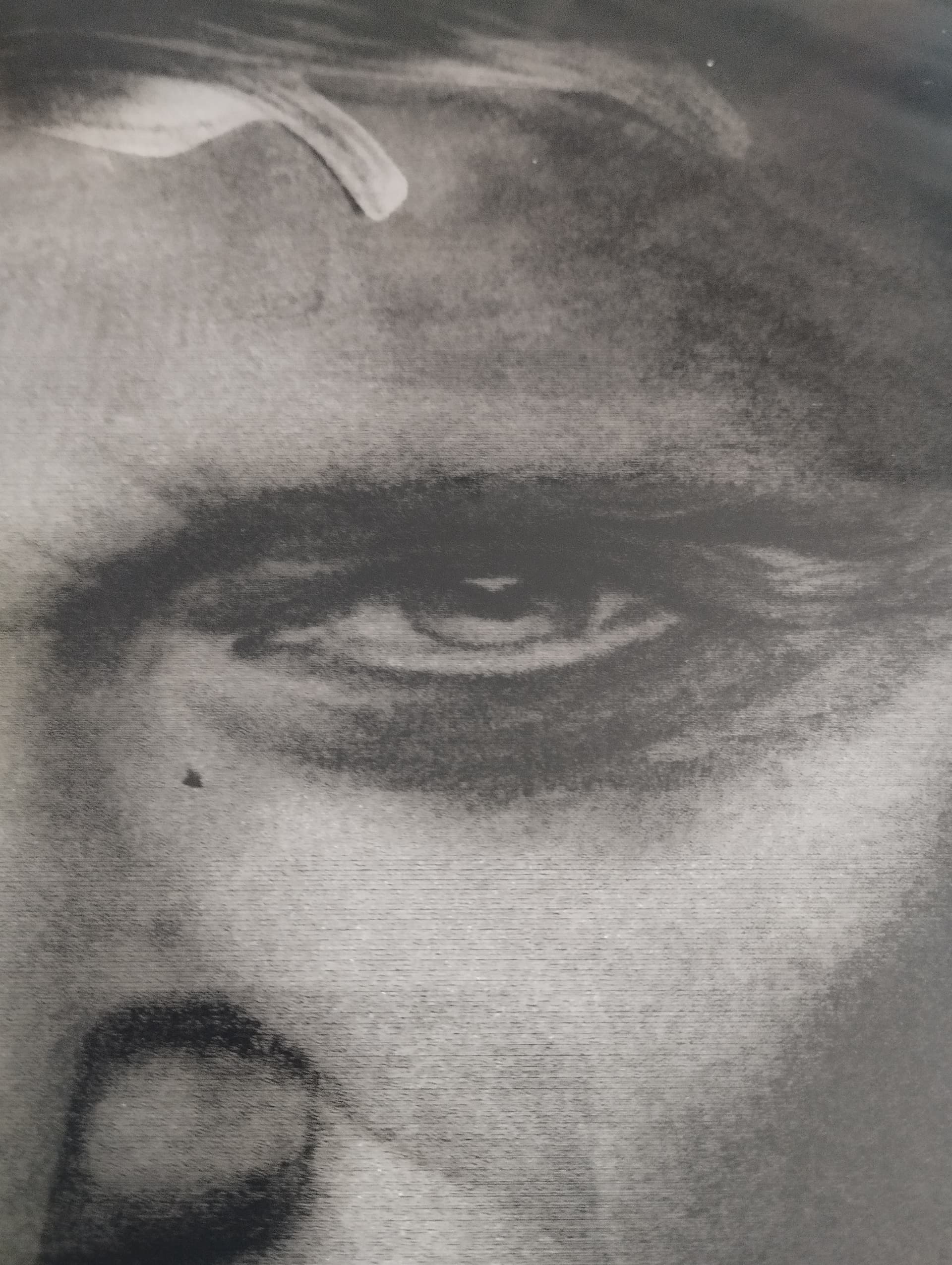

Hi All, I’m new to laser etching and have a query about how long it takes to etch a filled image. The image I had is a simple image measuring 125mm high by 83mm wide. The preview said that the image should take just over 12 minutes but it actually took 3 1/2 hours. Has anyone experienced this? Thanks for your help :smile:

I only see one issue here, but that’s not related to speed. Your $30 is 10,000 which should be 1,000, usually. Make sure to have an s-value max of the same value in device settings.
You could increase the acceleration from 500 to 1000, but this shouldn’t make a difference of hours.

Bitmap is image. Preview estimate is usually very close to the actual for vector or line engraving. Even with good machine settings, proofed with the Line work times being accurate, I have found images to be about twice as long as estimated. The technical explanation for why is beyond my pay grade.

vector files are lightening fast compared to image. Also DPI will affect image time
Ich habe den Selben nur mit 20 Watt , wenn es nur eine Grafik ist , passen die Zeiten . Bildern schaut es anders aus , Angesagt sind 1,5 Stunden und es werden dann fast zwei … aber ein 12 Minuten dingen auf 3 1/2 hinausziehen … hast du mal ein anderes Bild probiert ?
On the 10W, a 30cmx30cm photo on glass takes me more than 4 hours, 317 dpi, interval 0.05, speed 1000mm,power 50%,pastrough activated, and imagr norton withe tile , it takes time to get quality! But the final result is great…
