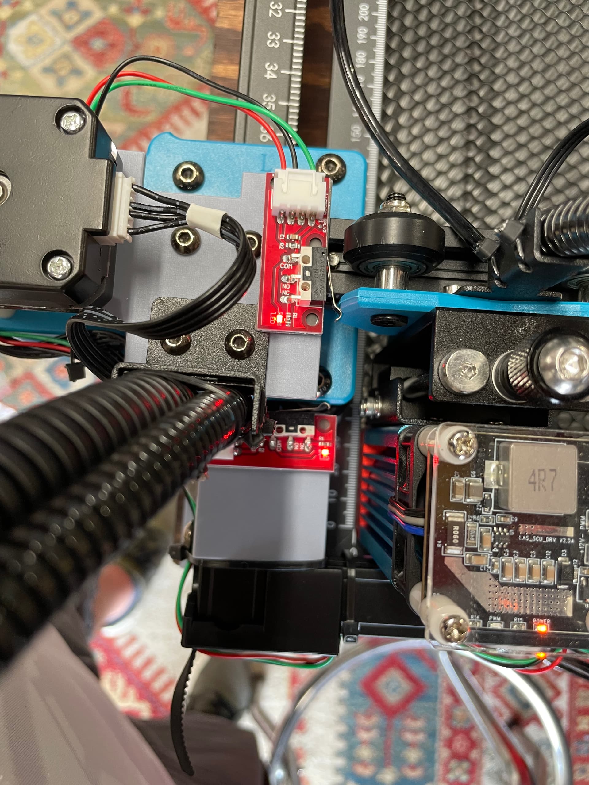

I have a TTS55 laser to which I have added Limit switches to.

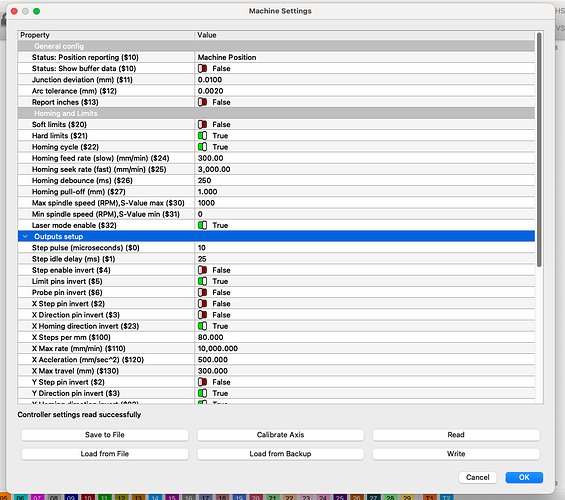

I have $21 = 1 and $22 = 1 and $23 = 3.

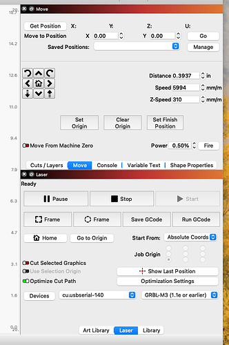

If I center the laser and click “home,” it goes in the right direction.
If I manually trigger either switch, it stops immediately.
If I let the laser trigger the switches, it tries to keep going.
What am I doing wrong?
If you only have homing switches I would disable hard limits and enable sift limits. I would also increase pull-off by a mm.
Resolved the issue by reloading LB.
What does these two sugestions actually do?
FYI: The only reason I am using Limit Switches is for the camera I am about to add.
Hard limits are if you have limit switches on all 4 corners. Soft limits will limit travel according to the work area you set up. Homing switches allow you to automatically home as opposed to manually setting your home. As I understand it. I’m no expert.

Grbl machines use the home switches as home. They can then be used as limit switches. If you only have home switches, then you can only use home switches for limit at two of the four ends.
Dsp machines use specific inputs for home and different inputs for limits. It does not look at the home switches after a boot. Usually the limit switches are outside of the normal work area…
This is a Ruida setup with limit switches… Red are home, green limits.
Soft limits (or software limits) are handled by the controller and will check each move before it executes to ensure that instruction will not drive it out of the working area.
