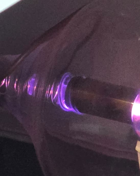

Hi, I run a RECI W8 since 4 years (about 3000 hours) without problem but it started few days ago to lose power (80W where I had 150W before). I also noticed an intermitant new humming noise that comes from the tube (not from the stepper motors) and when this sound can be heard, a glow appears inside the tube close to the cathode. Since it’s an intermitant problem (one minute correct, one minute in that condition), does this indicate a faulty laser tube that need to be replaced or a bad power supply?
Thanks for your help.
After 3000 operating hours I will probably replace both the tube and the power supply. You can always keep the power supply as an emergency reserve, but the tube is probably gone.
After 4 years and 3000 hours, the fault is most likely the tube going bad, but (IMO) you may as well replace the high voltage power supply at the same time because it’s the next thing to fail.
AFAICT, all claimed tube lifetimes are aspirational: “Up to 10,000 hours!” The warranty period, which has surely expired on your tube, gives a better indication of the actual expected lifetime in normal service.

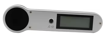

Is that by measurement or estimation based on reduced cutting speed? Either way, it’s a dramatic change!
it’s an actual measurement from my power meter at the exit of the tube before the first mirror:
I was expecting my tube to last more than 3000H but it seems concerted that I’ll need to invest a bit in the next weeks!
That power meter looks very interesting, do you have a link to this item that you could share?
I bought it from Cloudray but they don’t seem to have it anymore. I found this link if you want more detail on the product:
Handheld Laser Power Meter Hlp-200 Co2 Laser Tube Power Meter 0-200w For Laser Equipment Marking Engraving Cutting Machine - Buy Laser Power Meter,Hand-held Dynamometer,Power Meter For Co2 Laser Tube Power Meter 0-200w For Laser Equipment Marking Engraving Cutting Machine Product on Alibaba.com
I just got what looks like different version of the same thing:

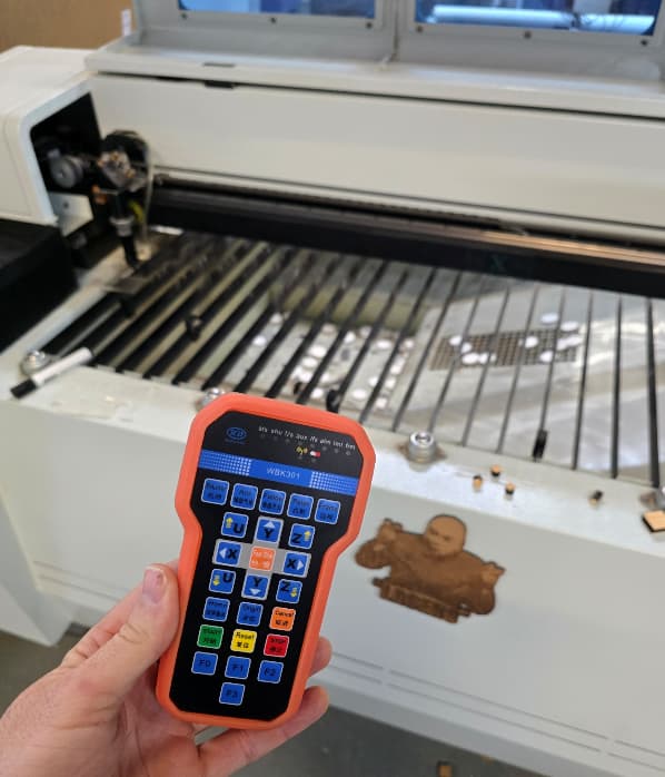

My arms aren’t long enough to stretch from the tube exit to the controller’s Pulse button, so the next project will be a fixture of some kind.
Here’s my trick, useful gadget for this kind of use, and a lot more things!
Ruida BWK301R | Best Co2 Laser Controller
Ooooh!
Then I could torch myself from afar! :grin:
