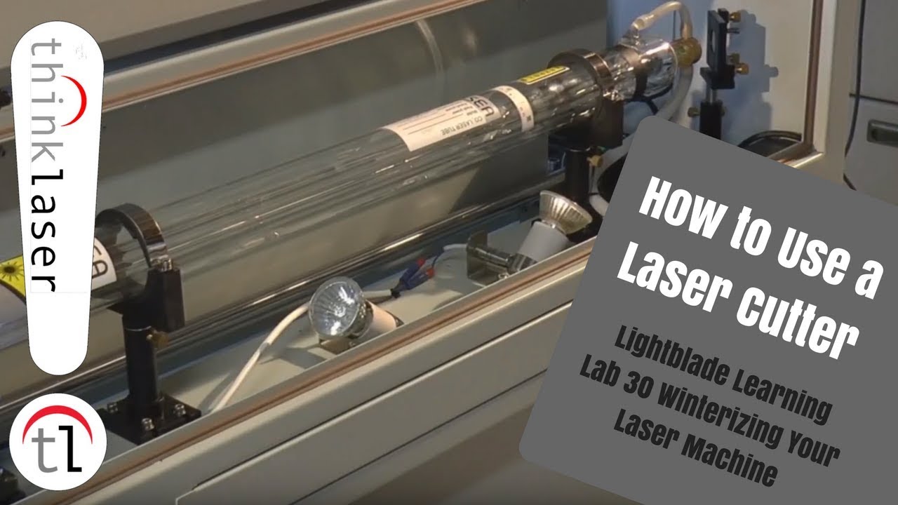

Hi there,
You may want to check out this video…
It might help a few of you guys??
Cheers
Thinklaser.

Thanks Gavin. Russ has great videos.
Even he says do not ever use antifreeze or EG.
His solution was to use high wattage heat lamps to prevent freezing. Seems like a fire hazard to me. What I did find interesting was just having the lid closed kept some heat inside his machine.
