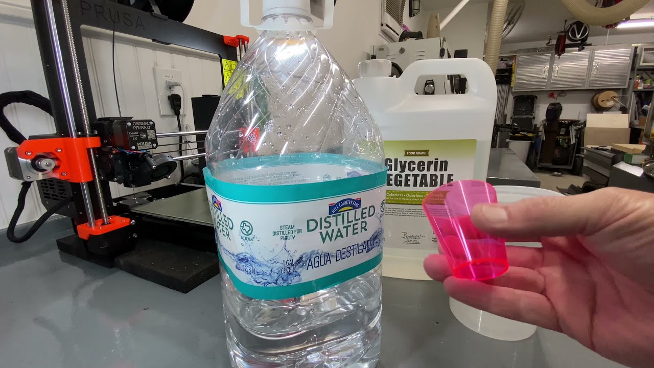

If you’re goal is freeze protection to prevent tube damage in the unfortunate circumstance of a power outage, my ā€œexperimentā€ shows that a 25% dilution of glycerin in distilled water (which ironically is the Magic Ratio for THE BEST fog machine fog juice) provides protection from freezing at least down to 8℉ / -13ā„ƒ.
The 25% dilution maintains a closer solution viscosity to that of water when at normal temperatures fit to sustain human life :slight_smile: .
The 50% dilution… I think is too much if you want to keep the viscosity lower / nearer to distilled water. However, that 50% dilution did offer some impressive results on freeze protection:
Perfect. I guessed about 16 dF, which is colder than I would deal with.
Think thats our new secret recipe, 75/25
With that viscosity, should work well in pump or my new S&A chilller.
Very interesting and thanks for your efforts.
This will certainly be doing the rounds on the forums once word gets out

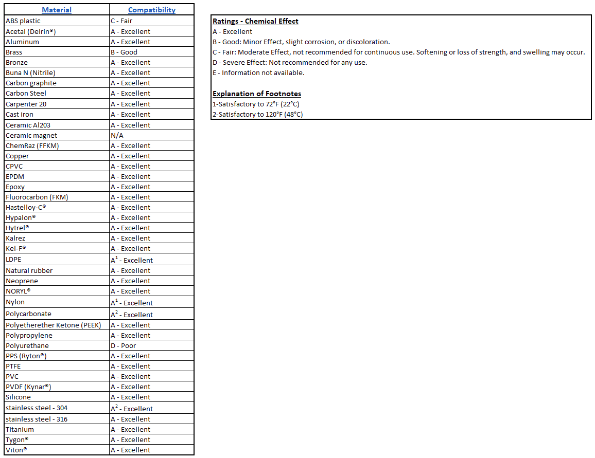

Additionally, I ran a material compatibility report from Cole-Parmer for Glycerin:
