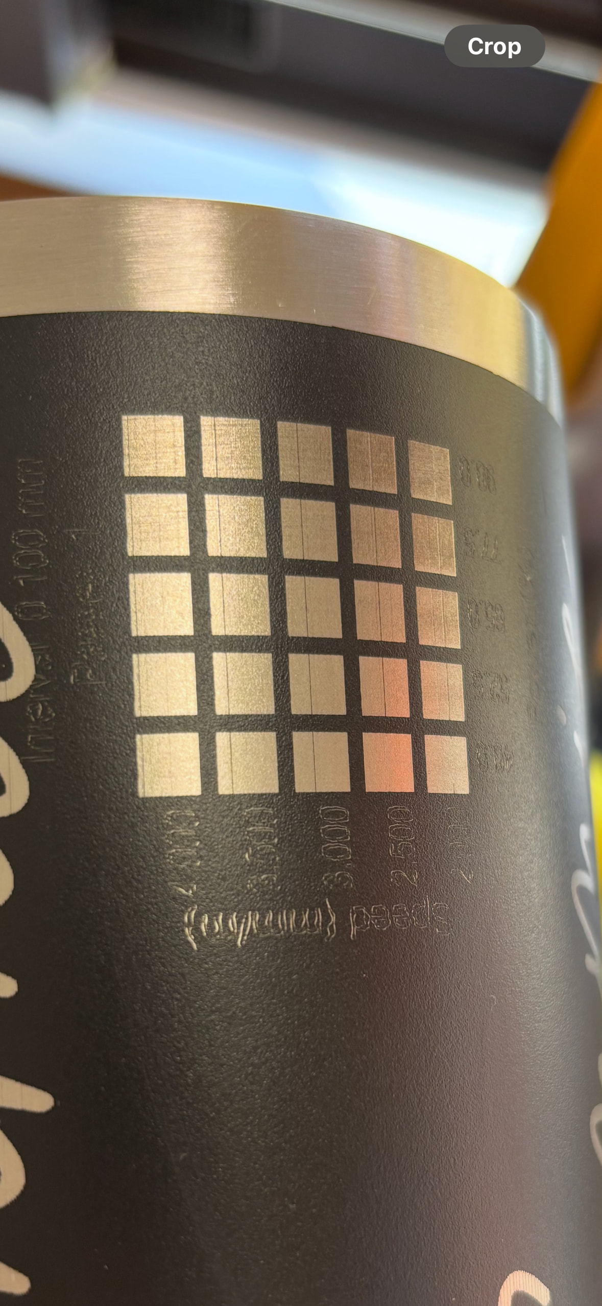

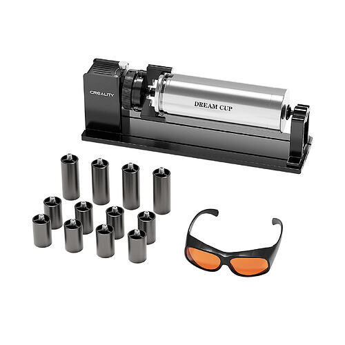

This has likely been asked plenty but i am struggling to find anything on my search. Hopefully a simple resolution, I am learning to engrave powder coated tumblers ( and I have an order coming up so need to fine tune now )
What i have is:
Creality Falcon A1 10W & Chuck Rotary System
Settings used ( after material tests )
7500 mm/m - 50% power - 0.08 interval
My issue being as you can see from the picture is the lines left behind after engraving and also what looks like part way down the design almost like the chuck has skipped ahead a slight bit. The chuck is tight as a tiger on the inside of the tumbler
Is there anything i can do to check or change to see if it makes an impact on quality - I have also given the engraving a wipe down with LA awesome and a microfibre cloth
Thanks in Advance
Assumptions:
  1. the material is stainless
  2. your tests were on another tumbler
Guestimates (because I cannot determine what the lines are made of):
  1. slow it down to the 2000-3000mm/m range
  2. Increase your interval to 0.1mm to see the effect
  3. continue testing

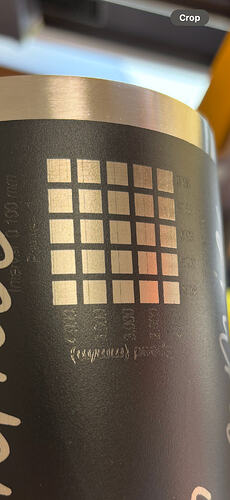

So a few tweaks here and there this is where i am at
I have turned off bi directional fill and its yielding a much better result - however there is still this line that runs through the squares and its different positions on each square? The bottom right ive picked off with my thumbnail after washing with LA awesome and a scourer clean up but obviously i dont want to have to pick lines out of a tumbler
Then the second photo is honed in on the speed and power but i have gone for 2 passes to try and eliminate the line - would you say that the 3500 @ 50% would be a good finish?

If you’re using this rotary:
I would make sure that you have set your diameter in the Rotary Setup window correctly - banding like you’ve shown is often caused by having a line or slice interval that is too small (along with a diameter setting that isn’t perfect).

Most likely, the reason that looks better is because the machine and (possibly) the chuck have mechanical backlash, as shown by the text:
Because the A1 is a CoreXY machine, belt tension is absolutely critical for proper operation: make sure they’re properly set up.
In addition, check everything mechanical in both motor drive trains to find & eliminate loose screws and sloppy assembly. The design of the A1 will make getting in there difficult, but it should work much better than it does.

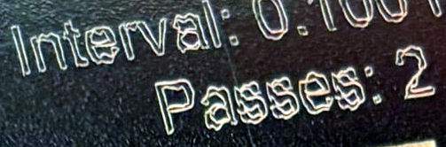

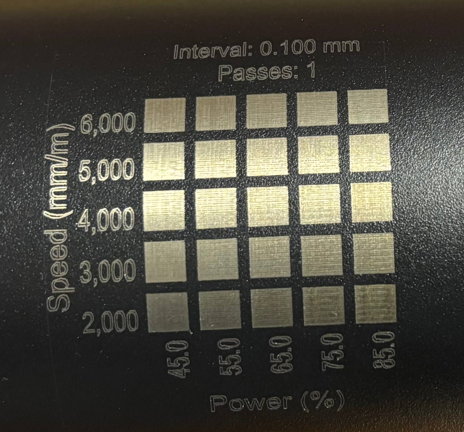

So I have run the backlash file and image is attached. From this i am going to guess its more the rotary chuck that might be the issue instead but i am unsure how to check.
Also as there is a taper, i have tried using the taper tool but i am unsure as to whether i should be tapering just the artwork individually or the entire rectangular template?
The flat test is perfect, which rules out mechanical backlash in the XY machinery: good!
However, that means the chuck has backlash.
Assuming it’s that chuck rotary, I was unable to find the manual / doc for the thing. However, it looks like a direct-drive setup, with the motor shaft connected to the chuck and no intervening gears / belts / machinery.
If that’s the case, start by carefully examining the coupling between the motor shaft and the chuck, which may just be a hole in the chuck. There should be a setscrew locking the chuck to the shaft and, if that screw is loose, the chuck can wobble on the shaft. Search very carefully to find that screw and tighten it.
After that, the speed may simply be too high for the machinery to handle, leading to the chuck overshooting the desired position and wobbling back again. In the text layer for the Material Test:
  • Reduce the speed from whatever it is now (let us know!) to 1000 mm/min
  • Drop the power from 50% to about 10%
  • Run the tests again to see if the wobbling improves
sorry for the delay been a manic work time
So i checked the chuck and found the screw and went to tighten it but it was already tightened

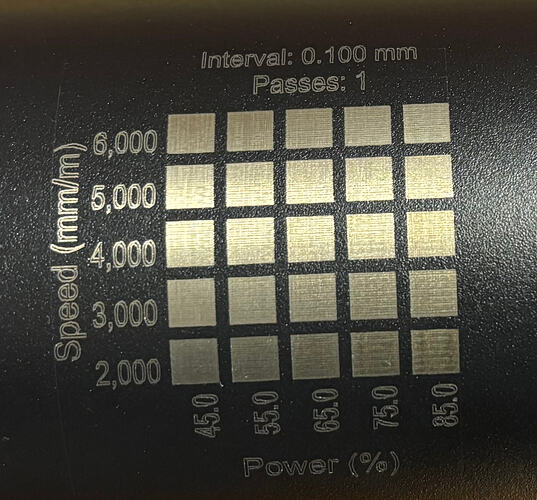

The text original was 1800mm/min as standard but the attached photo is 1000mm/min at 20% power the text has less wobble but still has some wavy lines
This one also still has the bi directional fill on
That tells you it’s still turning too fast for the machinery to handle: the chuck + mug oscillates after large rotary motions. After eliminating mechanical backlash, the solution is to just turn slow enough to avoid wobbling.
Drop the rotary speed to 500 mm/min and the power to 10%, then to 250 mm/min and 5%. At some point the power will be so low as to not disturb the paint on the mug, but maybe you can find a sweet spot in there somewhere.
You can adjust the rotary speed with the GRBL Y axis maximum speed in $111. Save the current machine settings before you tinker, so you can get back to where you were before starting; saving separate Linear and Rotary settings will let you switch without forgetting anything.
Go through the Scanning Offset Adjustment routine to crisp up the edges of those blocks.
Then run an Interval Test to find the proper interval for the focused spot size along the Y axis. Diode lasers (typically) have rectangular spots, so it’ll only be good in one direction, but that’s all you need here.

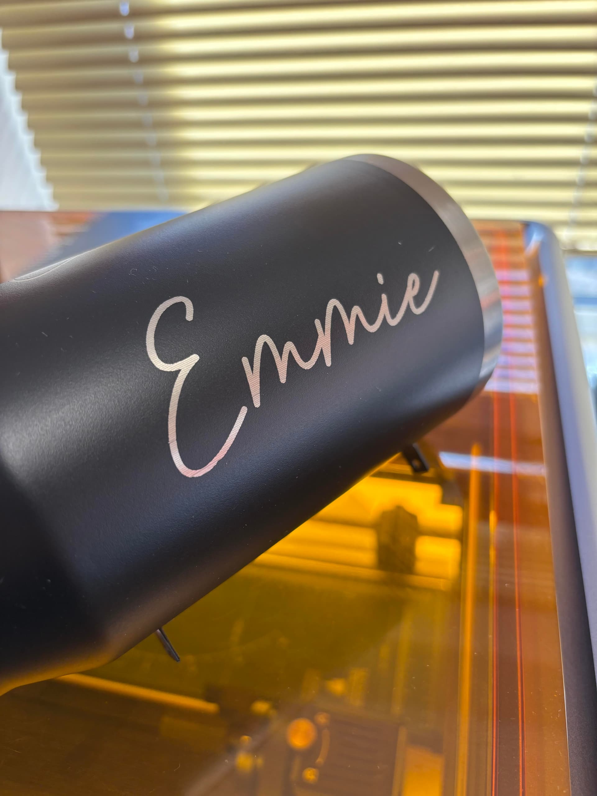

So … bit of an update here!!
Thank you so much for all your help, i did however have a little thought when setting up “another” test item.
On the creality they send you the legs in sections to elevate the housing so that you can fit the chuck underneath - i decided to use all of the parts and make it as tall as possible, in doing so i was only using one bolt on the laser to hold it in place.
I have since taken one section of the legs out and been able to use both bolts on the laser head to secure it in place and i have run a few wrap projects and other bits and have found no issue.
So this was completely my error here but wanted to ensure that i came back and provided an answer to this so it wasnt left unfinished on my part
Thank you so much again for your help, it has helped me understand the laser as a whole but also apologies for being a bit daft and not using common sense on this fact
