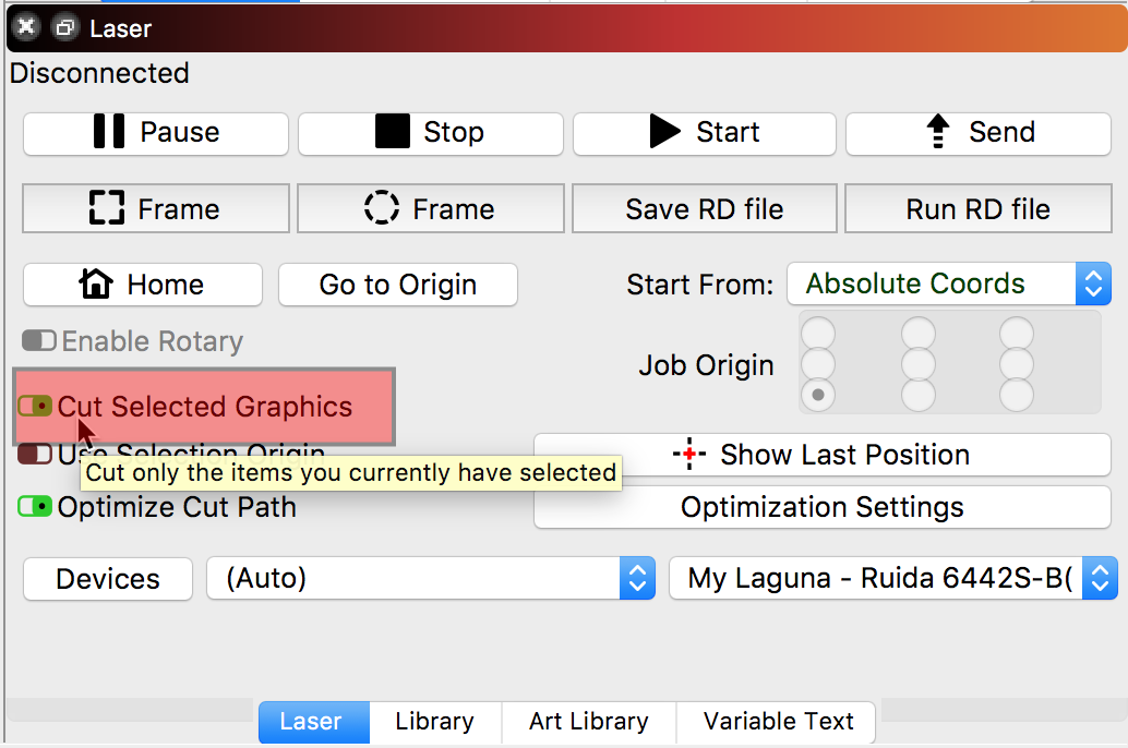

Two objects on one level, deactivate one
Hello,
first of all thank you very much for building such a great software.
Somehow I still don’t quite get along with the layers, or find it a bit cumbersome to handle them.
Suppose I have two identical objects next to each other, which are both on the same layer, because they should have the same settings. Is it possible that I only output one of them although both are on the same layer? Is it possible to mute an object without placing it on a new layer?
You can use the ‘Cut Selected Graphics’ to only output what has been selected.
oh my god, that helped me so much, thank you so much!
You are welcome!
