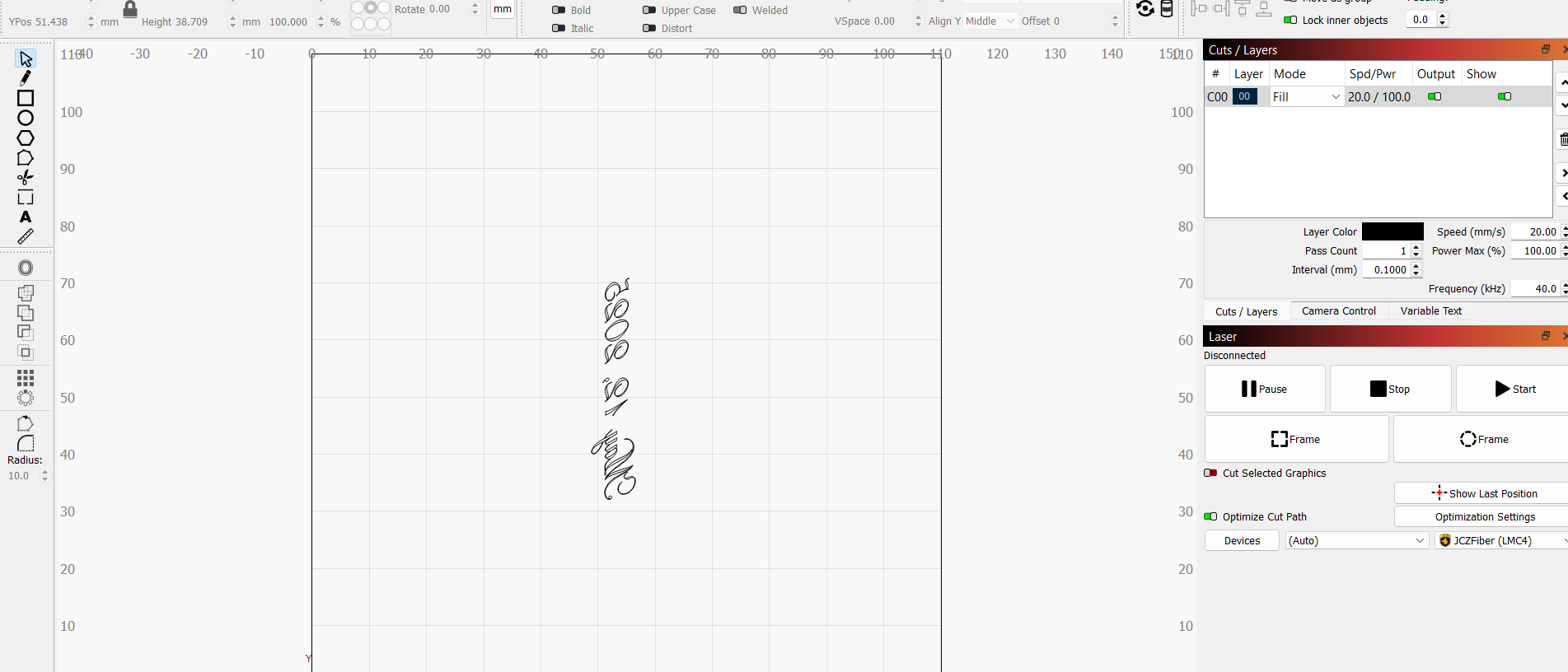

Typing or Image orientation problem
When creating a new project the orientation of what is on the screen has to be flipped horizontally and rotated clockwise twice for the project to engrave properly. Can someone help me in correcting this problem?
You most likely need to adjust your Per Galvo settings. Select the opposite axis as the X axis, and enable Reverse Direction (Negate).
That fixed the problem. Thank you very very much
